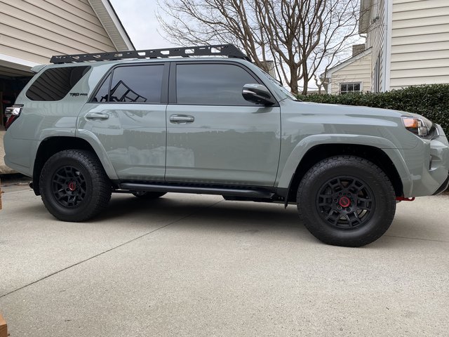

    Installed my kit and really enjoy the results. The ride is pretty much the same. Maybe just a very small touch firmer in front. Barely noticeable. Got 2” lift in front and 1.25” in rear. I have additional weight (winch, 2nd battery, drawers) so my fender height measurements are little below what Wescott describes at end of their install video. I am keeping the stock 265 Nitto’s.
    Install was smooth and no issues. Wescotts install video pretty describes everything. The only difference is the video was made with the pre 2021 PRO kit where the bottom spring perch is flat all the way around instead of having the offset and taller due to the different coils on 2021+ PRO’s. Therefore when the installer in video describes how to know when the new bottom perches are fully seated on the shocks, does not apply to the 2021+ kit. I just measured the location of the groove for the sleeves in the bottom perches and the location of sleeves on shock and did the math to know when they were fully seated as the sleeves are not visible when perches are installed.
    Before
    After
    I also installed OME UCA’s. With the UCA’s my alignment came out same as stock.
