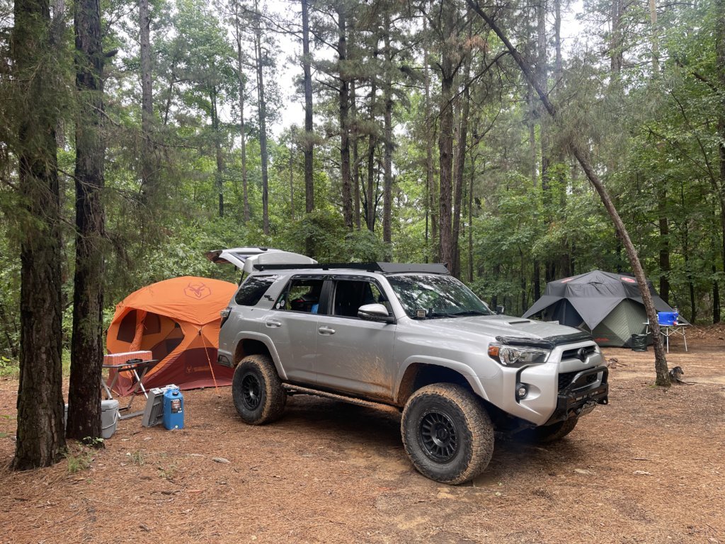

    Played in the mud a bit at Merus.
    Not going to let the weather ruin our fun

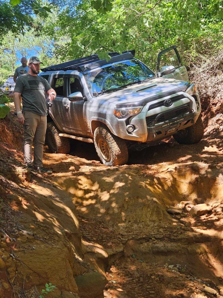

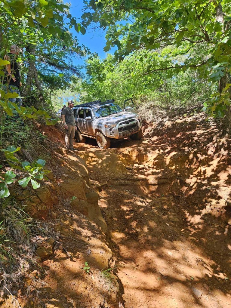

    One of the rigs in our group slashed a tire. We stuffed 14 plugs in the thing to get it back to camp.
    A Tacoma broke a sway bar link which nearly slashed his CV boot. Tied the sway bar up out of the way and kept running the trail.
    Recovered two vehicles that were stuck in the muck. One with the winch, and one with a kinetic rope.
    It was one hell of a muddy mess out there but we still had a ton of fun

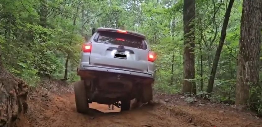

    After removing the front sway bar I started rubbing in the front during articulation. I got pretty tired of pushing the fenders back in and fixing the panel gap after every wheeling trip...
    I had a few choices.
    I could just remove the wheel spacers, but it seemed that wide stance really helped with off camber situations.
    I could reconnect the sway bar, but during normal driving I could barely notice it was gone. And off road it made a huge difference.
    To make it work I decided to chop the fenders. C4 fabrication sells a high clearance fender liner kit that I decided to pull the trigger on. This kit would not only solve the rubbing issue, it would also lower my chances of ingesting water since the viper cut and fender liner trimming exposed the air intake underneath the passenger side fender.
    Here’s how it turned out
    Installed some apex chassis tie rods as well since I’ve seen a few bend under stress.
