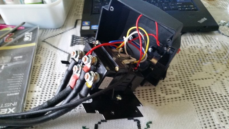

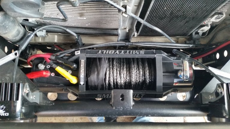

    I went ahead and finally did the wiring for the winch this weekend.
    Well most of it.
    The reason it took me forever to get the wiring done was because I couldnt find a good spot to install my winch solenoid box.
    I wanted the controls to be accessible and I also wanted the box in a good spot where it wouldnt take too much space or require me relocating stuffss..
    I give credit to @BigFishAllDay build thread on T4R.org for this idea.
    Changed a few things, but the concept is all the same.
    So here is this big clunky thing:
    If I open it, I get a smaller clunky thing:
    The idea is to take the solenoid out of the box and mount it directly without a box.
    I studied the wiring, made sure I knew where everything was going and what every wire was.
    I decided to mount the controller jack inside the 4runner. These wires for the controller jack will be cut and extended with the connection inside the cab:
    before I cut the wires, I went ahead and removed the main lead wires and wrapped the solenoid in thick electrical tape to make it "waterproof"
    I cut off the winch controller jack and crimped on connectors at the solenoid and controller jack:
    Not only did i crimp them, but i also soldered the wiring on there for a dependable connection:
    Then I picked up some color matching wire and made the harness to extend the controller jack into the cabin of the 4runner:
    Once all this was complete, I looked for a suitable location for the taped solenoid.
    I saw a nice spot next to the battery:
    Its a little dark, but you get the idea. I Like the fact I can use the factory hole to run wires thru.
    Installed solenoid:

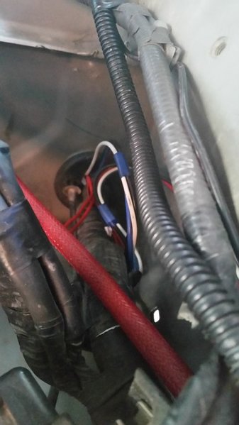

    Obviously the wiring that the winch came was not long enough for this location. I had to make my own wiring:
    I ran the wiring from the solenoid thru the hole in the inner fender and towards the winch:
    I then ran my controller jack wiring towards the 4runner cabin:
    Made all the connections for the controller jack wiring, taped them up nice and well to prevent any moisture from reaching the connections.
    I decided to get rid of these dummy switches and buy a tan switch blank to install my jack here:
    after installing winch jack:

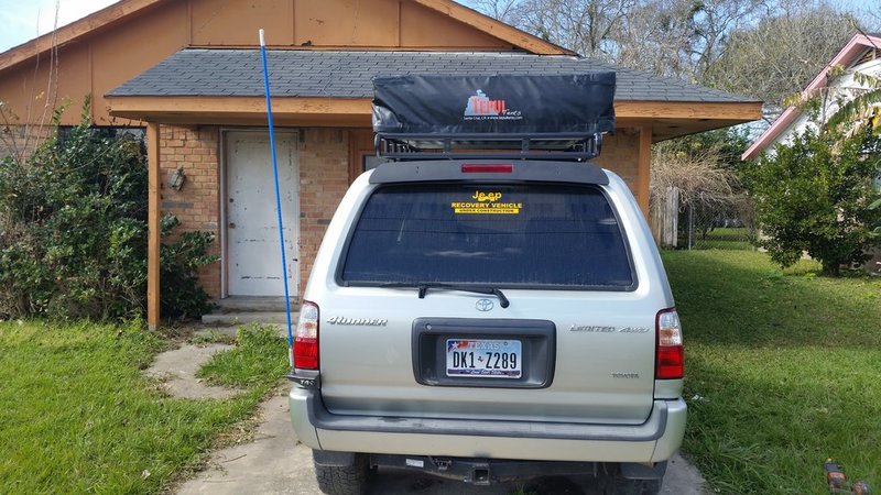

    Ended up setting up the tent before the Tacomaworld citrus meet.
    Had a friend come over and help me load it up on the 4runner.
    Wasn't too bad loading it up.
    Threw it on the bed of the taco first, got inside of the taco bed and then swung it over to the top of the 4runner.
    Fits perfectly under the carport:

    ended up coming back and redid some wiring:
    In the engine bay:
    Placed the solonoid back in its box and it fit perfectly hidden beside the battery:

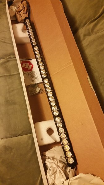

    Thanks to Bailey @Baja Designs for putting up with my endless questions in regard of the lights. Finally purchased a third one to install in the middle.

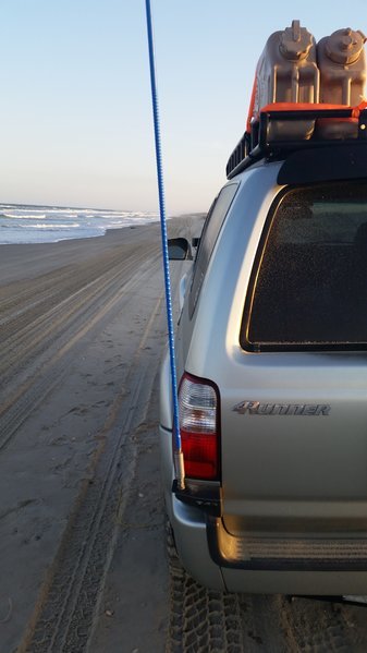

    went on a beach run to test out the new tires!

    Hmm.. time to run some wiring:
    I decided to tap into the trailer wiring, good thing they were labeled. I tapped into "Tail" and "Ground", black and white:
    Run wiring and attached using quick splices - I made sure it was well wrapped in electrical tape:
    Clamped it to the rear tube of the bumper, where it is hidden. No, I don't mind the hose clamps. It cant be seen unless you are looking for it.
