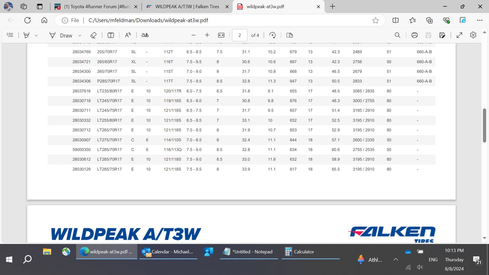

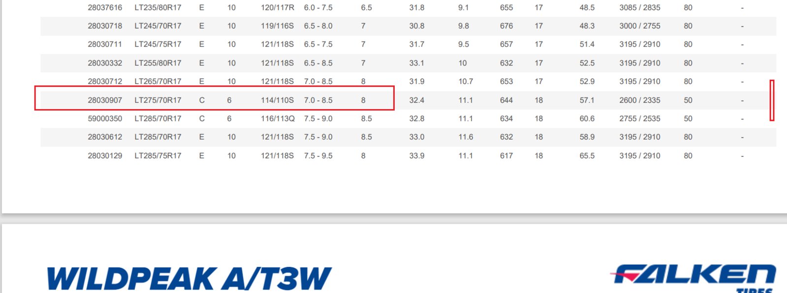

    Falken WP AT3s have a 275 C Load... BUT they are indeed ironically heavier than most 285s... go figure?
