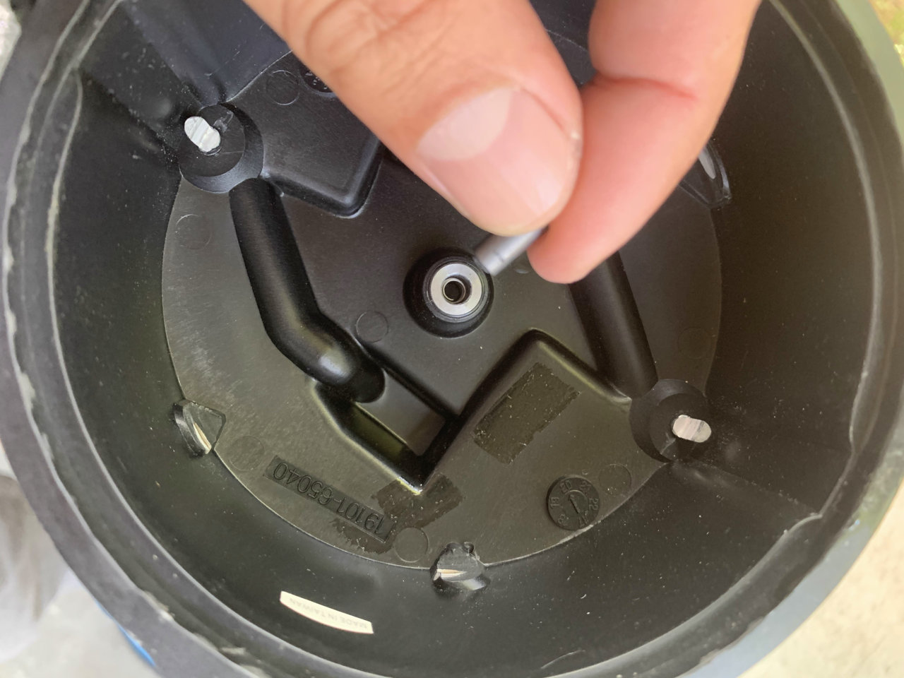

    I ended up replacing the distributor cap and rotor twice since the first one (Intermotor brand) broke.
    The middle piece (looks like its made out of graphite) of the distributor cap broke.

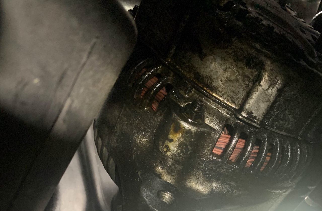

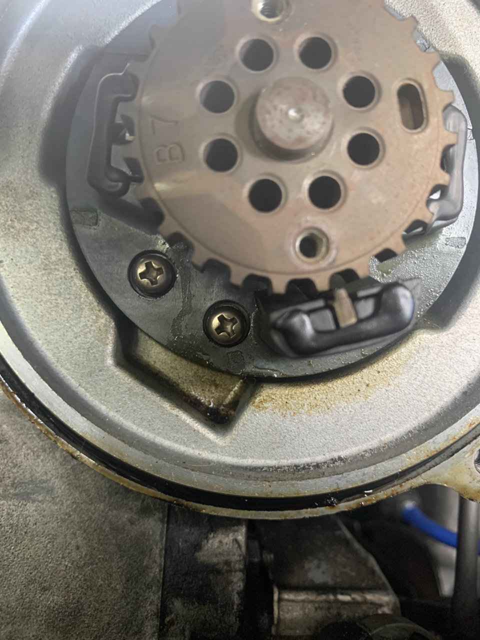

    I took off the cap because I noticed some oil around the outside of the distributor and on top of the alternator. I think its the distributor gasket that needs to be replaced.
