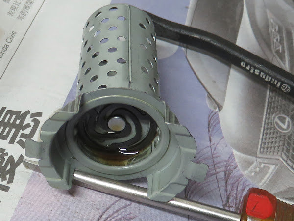

    Re. the metal oil filter housing upgrade. Not sure if it’s been mentioned already but I’d watch this if you haven’t already before making that upgrade. There’s more to that housing standpipe assembly than meets the eye. That spring at the bottom of the standpipe is a calibrated pressure relief valve. Having learned that I’m not messing around taking it apart. I’m just sticking with my original plastic filter housing. I just use a torque wrench and a good filter wrench like MotivX for oil changes.

    AMD is wrong with the coil spring, which is just there to press the filter against the inlet, to accommodate variations in filter height. The bypass valve or pressure relief valve is a wave spring-backed steel disc at the base of the center tube, visible when you separate the tube from the cap and look at the bottom. When you transfer the factory center tube to the aluminum cap, the factory bypass valve is transferred over as well.
    The bypass valve has a high duty cycle, as it opens every time you get on the gas before the oil reaches operating temp (~first 20 minutes of driving).

    Interesting. So what’s the coil spring for? I thought the disc was to release oil through the drain at the bottom of the filter housing, and the coil was for the bypass.

    ^The coil spring is just there to press the filter against the engine filter adapter inlet, to accommodate variations in filter height as they can vary amongst different batches and different brands.
    The check valve for draining the filter housing is built into the housing.
