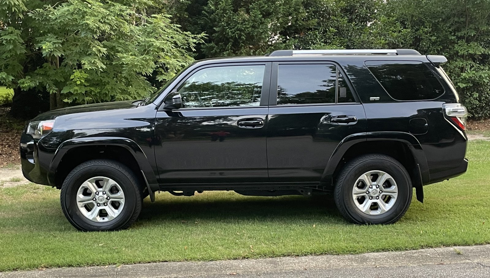

    RCI skids Eibach stage 2 leveling kit
    I have 23 ORP with KDSS. My leveling kit consists of Eibach stage 2 leveling kit. Very happy with it. Stock UCA and no Dr KDSS. Also have RCI skids. I live in salt prone area and Eibach made it through first winter with no rust.
