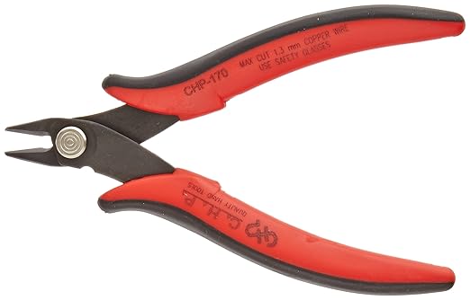

    You got more finesse than me then! Cause I couldn't get Philips H9s in my 2020 without trimming both the big center metal tab AND one of the others. Maybe I was just incompetent, but I didn't have that issue on the Subaru I was running H9s on.
    PS, as others have noted the micro cutter or similar snips take off the plastic tab in the connector with zero trouble. It's like literally a half a second to do it. No Dremel needed. I also use them to trim the metal tabs, though I did snap one of my micro cutters in half once while doing it... So this last time I used mini pliers to just bend the extra piece of metal tab back and forth until it broke off. Took 5 seconds. So I've never needed to use a Dremel or a file.
    Sorry I didn't take pics.
    PPS, the cutters and the micro pliers came in a set for $15 at Home Depot.

    Yeah, what @2016 4Runner SR5 said. Super easy mod with a pair of snips. I didn't use a file, but that'll work too.

    My H9's fit just as snug as the H11's. Did you line up both bulbs side by side to see exactly where you needed to trim the metal tab?

    Hi nimby, thank you - yes, I lined up the H9 to the H11 to estimate the 2 cuts on the metal tab. I used side cutters to make the cuts, and now I think the cut edges are "rough" and probably making it difficult for the bulb to properly align/fit like the H11. I think a Dremel is needed to clean up and smooth the edges for the fit to work. I will try again on the weekend when I have access to a Dremel.
  24. Sep 3, 2020 at 7:36 PM
    #84
    4,782
    Hope you figure it out. I just used some micro cutters to cut the tabs. It was clean and easy.
    Is it possible that you bent the metal tab slightly towards the actual bulb while cutting? This might make it a little looser when trying to fit it onto the headlight housing.
    7385 and ElectroBoy like this.

    Thank you nimby. I got access to a Dremel today and trimmed more of the metal tab. Now the H9 bulb installs and fits snug just like the H11!
