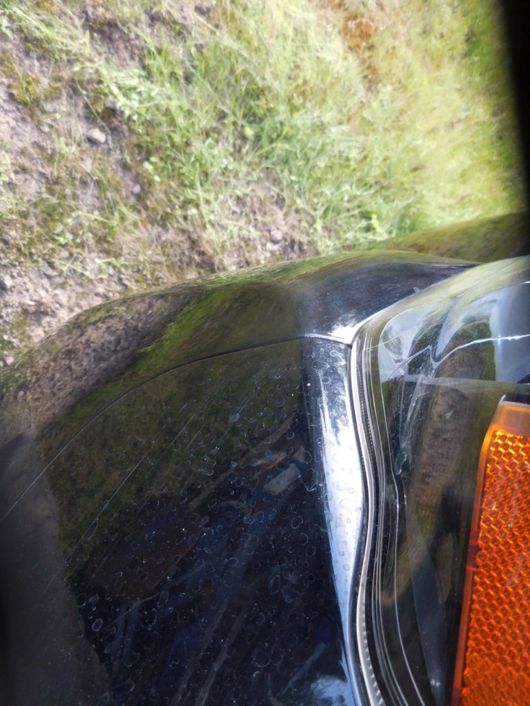

    Just to document it, I am having this on the drivers side. I just noticed it a couple days ago, thought it was odd, gave it a whack and popped it back in. Thought about how it could have happened for about 3 minutes and forgot about it.
    Then I stumbled onto this thread yesterday and just went out to recheck it and sure enough its popped out again. Guess I'll be following this thread.

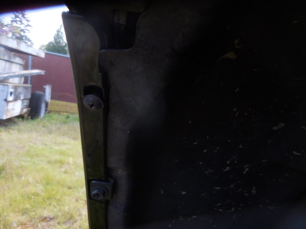

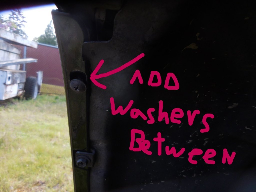

    I forgot I had this file. I believe I pulled it from a thread on this forum.
  9. Sep 23, 2024 at 11:02 AM
    6,883
    Albuquerque, NM
    This "fix" has been tried by several members, with mixed results. Mostly no permanent fix.
    Their "dual-lock fasteners" are strips of velcro.
    Number16[QUOTED] likes this.
