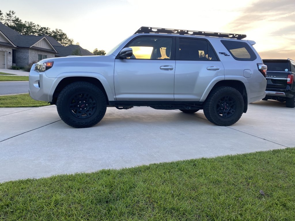

    964

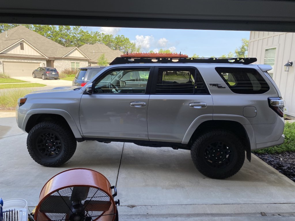

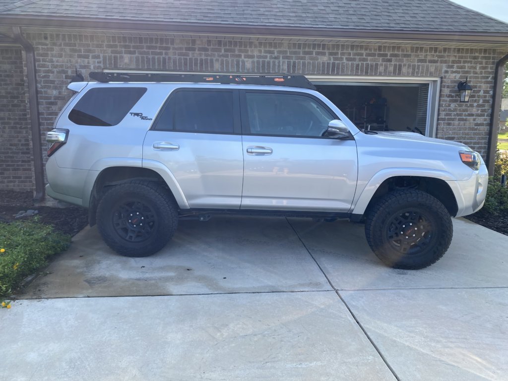

    Gang,
    Anybody here have before and after pictures on the C59-327 Coil Springs? These are the 2" - 200-400LB heavy rear load weight. I'm coming off a 2" Icon and wanting to see how the back looks. Thank you!
