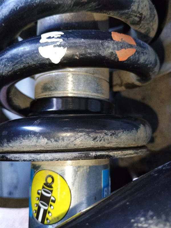

    Hey @Crikeymike Love all the info here! Thanks for taking the time to answer all these questions.
    I am looking to get some springs and need some insight. I currently have 5100 shocks front and back (on stock springs I believe) so I was looking to get some dobinsons springs. My front, from what I can tell is at the second perch currently on the 5100s. Which should be .85" of lift. But I am currently measuring 22" from center of hub to fender on the front. 22 1/4" in the rear. 22" seems high for the stock springs at the .85" perch.
    I was wanting to get the 300 front and 599 rear for a 2/1 lift and get a little rake due to towing a small teardrop trailer and boat.
    Sounds like putting the 5100's on the first perch with the 300s would get me right back to where I currently am? Then the rear would get me an inch or so of rake back. Do not want to mess with UCA's or anything so wanting to stay under 2.5" front lift. Soon to be getting a rear ladder as well. I suppose if the rear is a tad too high with this I could raise the 5100s 1 notch as well?
    Recommendations? Thanks!
    captrussia253 and Crikeymike[OP] like this.

    Hey bud
    So you're at 2" of lift up front already. You probably can't see the other clip heights behind the spring perch. C59-300 with stock weight usually sit at 22" on the front.
    In the rear, you're a little higher than stock, so I wonder if there's a spacer back there. C59-599 usually sit at 23.5" unloaded.
    C59-300/C59-599 would be a good combo though, having that little bit more rake so that you can tow easier without squatting as much would work out well. They're also stronger than stock, so they don't squat as easily.
