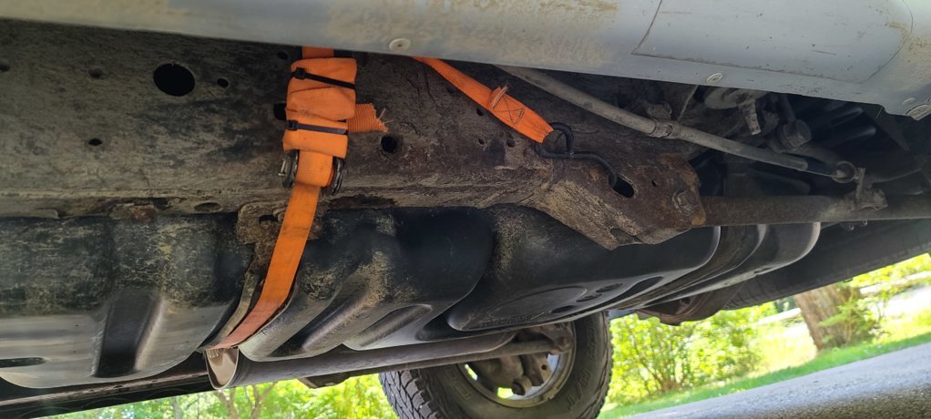

    Used a 5 dollar ratchet strap to hold up my gas tank after the rotted out tank strap failed.
    Worked like a charm. Lol.
    Update; I have since stripped and repaired the frame and strap and everything that was rusted and its all painted and in good shape again.
