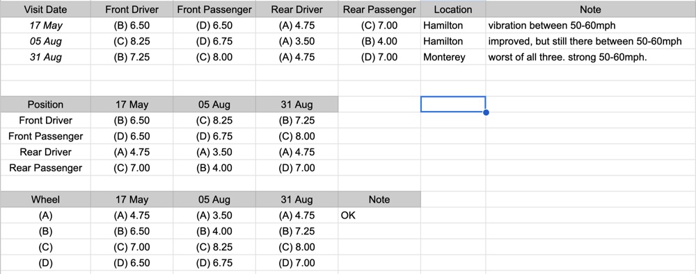

  21. Aug 23, 2024 at 12:17 PM
    #111
    jasonmcelroy
    May 17, 2021
    #21537
    238
    Jason
    San Jose, CA
    2021 Grey Trail
    Here's some anec-data for the nerds among us.
    Put 285 KO3 set on two months ago.
    Good:
    - super quiet compared to the 40K KO2 set taken off
    - track nicely at freeway speed and at slow speed
    Bad:
    - persistent steering vibration from 50-60mph
    - checked balance job shop did and see 6-7oz on each wheel (I think that's too much, but they are heavy tires)
    - took in for rebalance and they came back with 3-4oz on rears and 7-8oz on front!!!!!!
    At this point I'm certain the shop are clowns (as evidenced by their workmanship) so I can't rule that out as a factor yet.
    Went in today to ask that they be replaced with a set that can be balanced but was forced into getting yet another rebalance to "make sure it's right". I asked them "How will the third time be different?" and "Why didn't you 'make sure it's right' the first or second time you balanced them?".
    They didn't like this line of questioning and blew me off.
    Have to find a new shop. Annoying hassle.

  22. Aug 23, 2024 at 1:46 PM
    #112
    Nick B
    Nick B New Member
    #40493
    355
    SW Florida
    2010 TE, 2024 ORP
    National chain tire shop ?
  23. Aug 23, 2024 at 2:27 PM
    #113
    CalcityRenegade
    CalcityRenegade New Member
    Feb 14, 2023
    #31252
    675
    Matt
    2023 T4R ORP KDSS
    Look into road force balancing. Have not required it myself, but many swear by it.
    Klinsman55 likes this.
  24. Aug 23, 2024 at 2:46 PM
    #114
    TrailSpecial22 New Member
    1,802
    PA
    if they donr start with the yellow dot with the valve stem they’ll be chasing balancing and weights all day. And yes everyone, the yellow dot goes to the valve stem as i verified directly by Falken Tires when I first started using them as one shop put the red dot on the valve stem and it required a lot weight on the opposite side to compensate. Once they reorientated the tire, it only needed 2 oz of weight compared to 5.75 ozs.

  26. Aug 23, 2024 at 9:27 PM
    #116
    Klinsman55
    Klinsman55 New Member
    Jun 25, 2020
    #15122
    360
    K
    Northern Nevada
    2024 LE silver
    XREAS. Cooper Discoverer Road and Trail AT 255/75r17. Trd Pro Wheels
    2 votes for road force balancing. Discount tire did mine in 20-30 minutes tops in and out and drive great. Prior shop took 4 plus hours mounting and trying to balance and i drove home with steering wheel wobble (plus a bonus dent in side of my car im pretty sure wasn’t there when I dropped it off)

  30. Sep 5, 2024 at 12:53 PM
    #120
    jasonmcelroy
    May 17, 2021
    #21537
    238
    Jason
    San Jose, CA
    2021 Grey Trail
    C load. Don't need E.
    Have since taken in for *another* rebalance and the shake is worse. Have asked for a replacement set (called corporate) and have an appointment to tomorrow. We'll see how it goes.
    For the data geeks (I'm one for a living) here's some red meat. Notice how every time they're balanced they come up with a different weight (shown in ounces).
    PITA.
