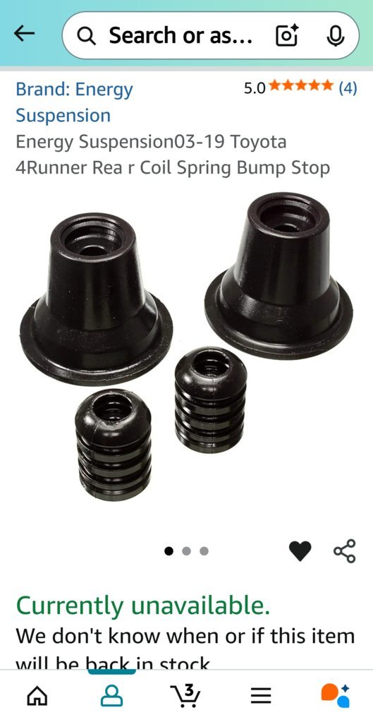

    Getting into the weeds about using air bags which are inserted into coil springs. Humor me, this is how I do things and you guys are my sounding board.;)
    Addressing my concern of their use in off roading conditions. The bags do not grow vertically when air is introduced. They grow horizontally, providing an air cushion between each coil spiral. The more air added relative to the load that's being supported the better the cushion(up to a point). The suggested amount of air to be added can range from between 5 and 35psi(max). For my intended use I have not discovered anything that alarms me about using them. Yes, there's a possibility of puncture...........but, I could just as easily blow a shock seal;)
    Today I'll be taking measurements to verify just how much of the factory bump stop(jounce bumper) needs to be removed(versus recommended)?. The bags are 7.5 inches tall(plus a thin spacer used at the top of the bag to protect the bags air fitting). I think this measurement is of critical importance? I think.
    "The modern 'jounce bumper' also acts as a progressive compression spring under loads that are approaching full compression."
    Once installed my preference is to have the bags contact the bump stops(jounce bumpers) as close as possible to 23" measurement(center axle to fender-well),as is possible. *23 inches was the measurement before the gear(fridge, Jackery, shelves, swing out, spare tire, traction boards & mount.... etc etc) were added.
