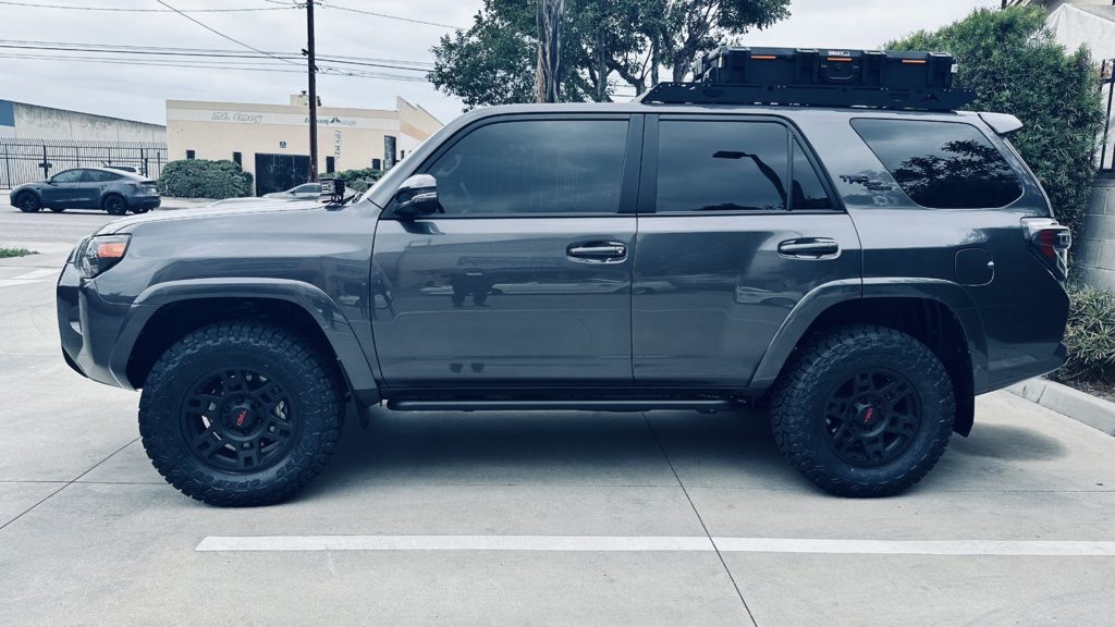

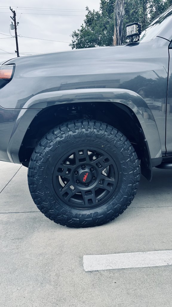

    Joining to 275/70R17 club soon. Will be getting C load.
    what tire pressure do you all use on pavement?
    Alternatively, what’s the lowest pressure when airing down before risking breaking a bead? 15 psi?
  19. Feb 22, 2025 at 5:49 PM
    #79
    semprenissart
    semprenissart Mèfi
    Dec 22, 2021
    #24758
    1,045
    2022 4Runner TRD Pro (MGM)
    So far on pavement I’ve been setting the pressure around 38-40psi and it feels good.
    I’ll monitor the tread depth in 5k miles to see if it wears out evenly.
    eventually I’ll probably get a small lift with eibach springs but so far no issue with the stock setup up.
    I have Falken wildpeak at3w load C which are slightly bigger than a typical 275/70r17 at 32.4in according to their website. I could feel the tire barely rubbing at full lock in reverse so I trimmed the front fender ever so slightly and now I can easily put my whole hand between the tire and the front fender. Did not have to remove mud flaps are there’s a decent gap.

    Its not the height of the Falkens its the width, they are 11.0" which is wide for a 275/70r17. This is why they rub but yet the infamous chart has a green square.
    semprenissart[QUOTED] likes this.
  27. Feb 25, 2025 at 9:09 AM
    #87
    semprenissart
    semprenissart Mèfi
    Dec 22, 2021
    #24758
    1,045
    You're right, the width definitely has something to do with rubbing.
    Probably a little bit of both since they're taller and wider than a typical tire of that size.
    Also that chart is based on stock off road tires with an offset of +15mm. TRD wheels are +4mm
    Here are the official measurements compared to the Toyo AT3s:
    Overall Diameter (in.) ; Overall Width (in.)
    Toyo AT3: 32.2 ; 11.0
    Falken AT3W: 32.4 ; 11.1
    although with minor trimming, they fit perfectly fine. Yesterday I put them to the test at full lock and fully articulated. Not a single time were they rubbing or made any contact.
    Also on the plus side, my speedo use to be slightly off with the stock tires (it read 77 mph at 75mph) and now it's dead on (speedo shows 75mph when gps shows 75mph)
