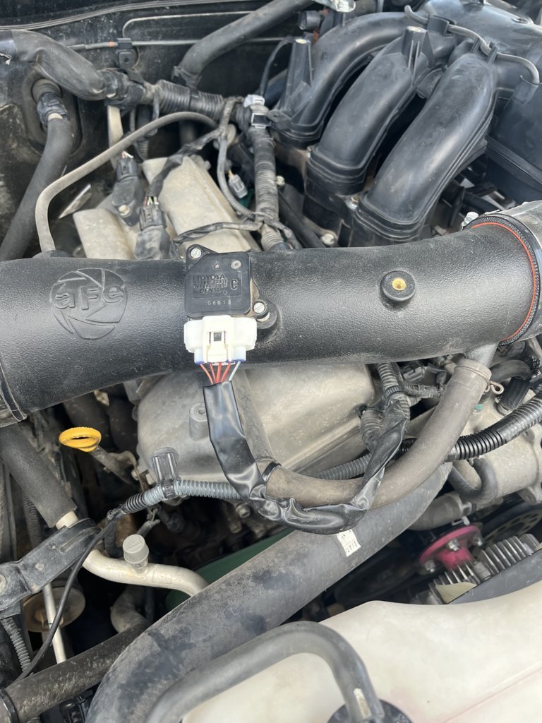

    Installed an AES intake manifold spacer a few days ago. That required some moving/refitting of several things. I trimmed the bracket for the ACIS sensor on the manifold and flipped it upside down because the harness was stretched. The vacuum lines for the FPR and running on top of the manifold were replaced, they were barely long enough. Then the throttle body coolant lines were in a bind too, so I pulled those off, and bypassed it using one of the old hoses looping it from one fitting to the other. I did this mainly because I was worried about a coolant leak becoming an issue over time.
    Then finally, the aluminum extensions for the intake support brackets provided were an after thought, so those went in the bin. I ordered a spare set of intake manifold brackets and cut and tig welded them back together so it looks more factory.
