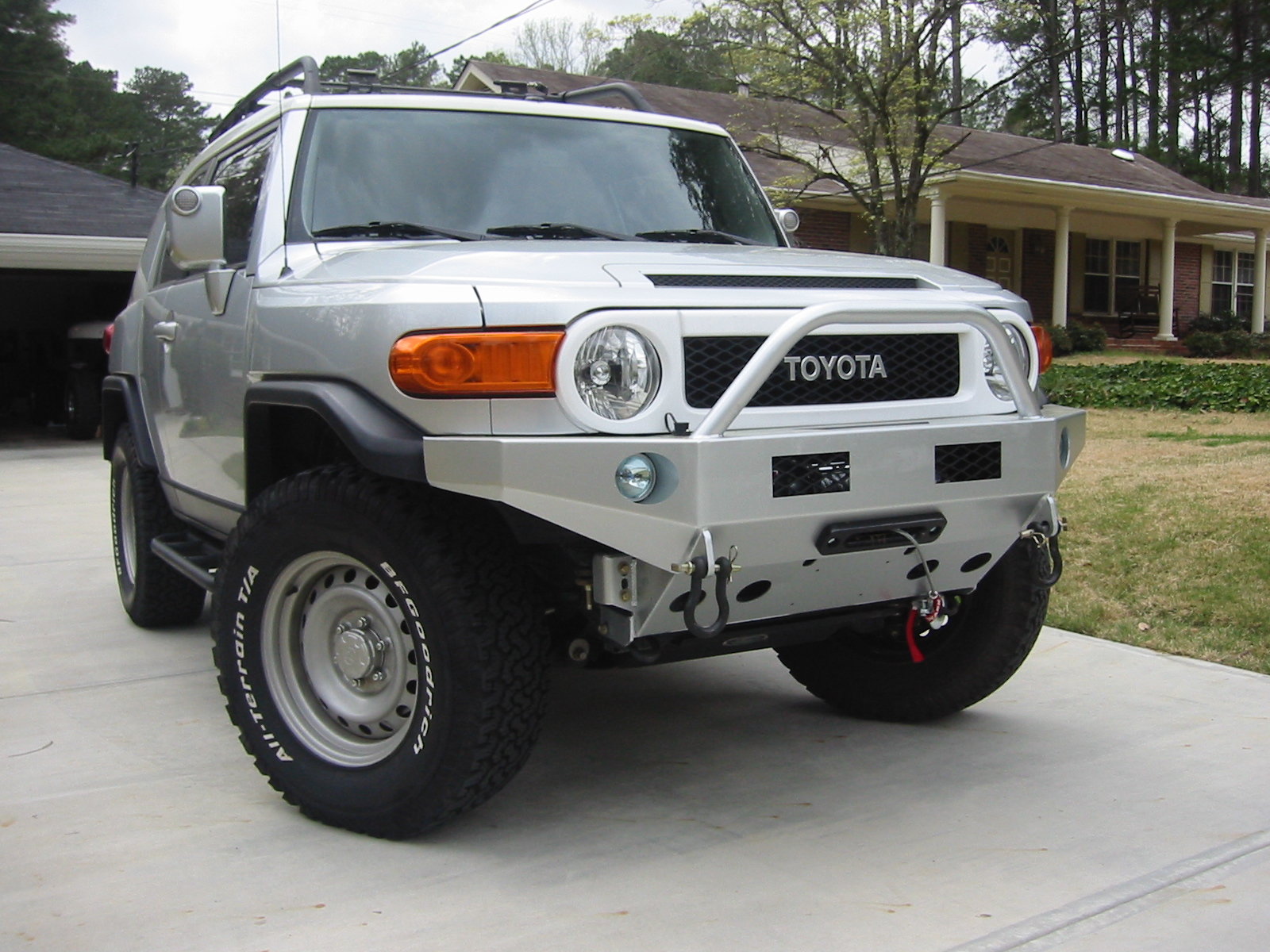

    I've had lots of parts for my other Toyotas sand/media blasted then powder coated by my favorite shop. The parts go from the blast cabinet to the booth - no time to oxidize. But having anything sandblasted then bringing it home to paint... I'm not kidding - the conditions have to be sooooo right for that to work. On the east coast, the humidity will cause raw/clean steel to "flash rust" in minutes.
    A few years ago, I bought a winch bumper for my FJ Cruiser - raw. The plan was to paint it myself. I think my experience must've been similar to @Yobruhitsme's. I sounded like Clark Griswold when the Christmas lights wouldn't come on.
    I degreased it, washed it to get rid of the degreaser, then wiped it with acetone... and before I could get the primer flowing, the orange haze set it. It was literally rusting before I could get paint on it. I had to do the bumper I sections - wipe, paint, wipe, paint, wipe, paint - just to get full coverage of primer.
    ^That^ is kind of a worst-case scenario. I should've waited a couple months to clean/paint the bumper. Humidity at 45-60% and temps between 55 and 70 degrees would've made that project much (!) simpler.

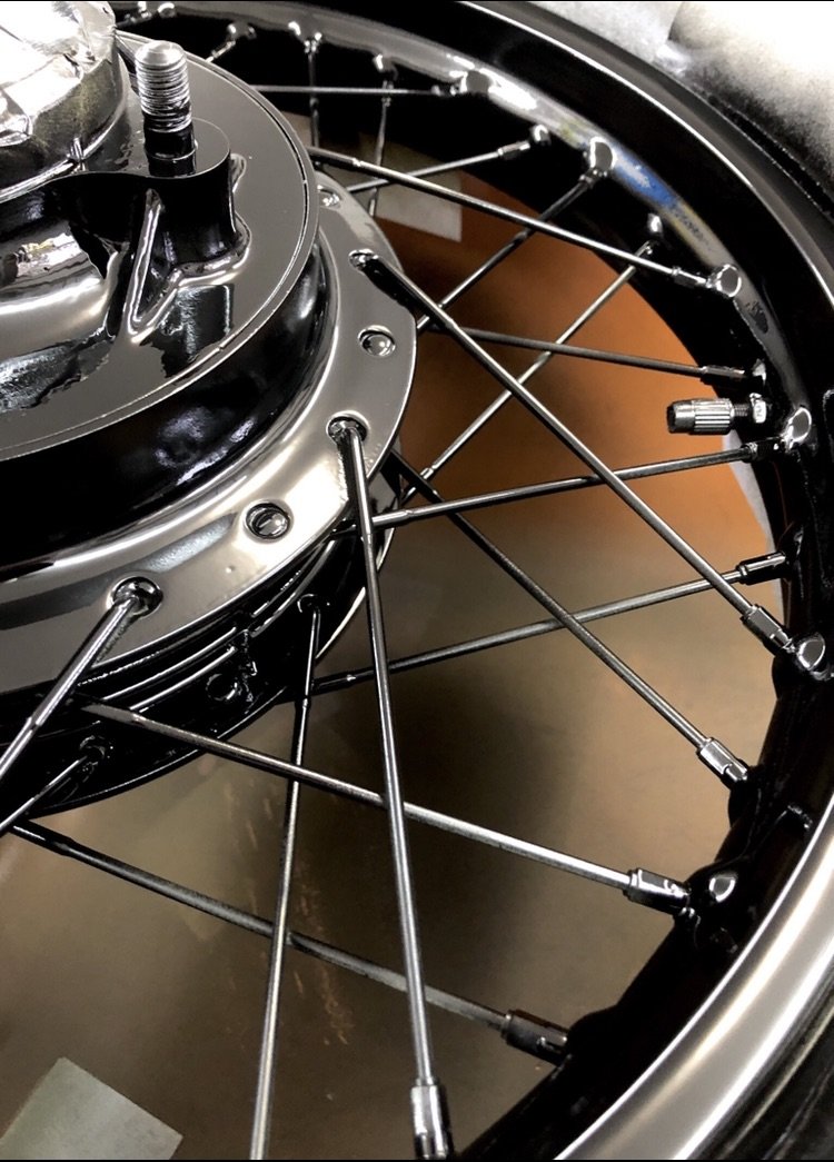

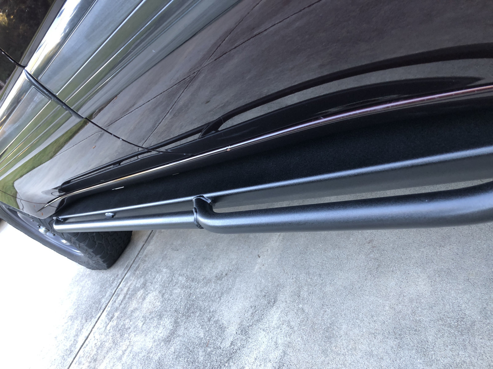

    Because all posts are better with pics...
    Everything on the Jeep was rattle canned - the body, cage, wheels, bumpers... The FJ's wheels and bumper were rattle canned. I also "half-cafe'd" a '73 CB500 - gloss black wheels, etc.
