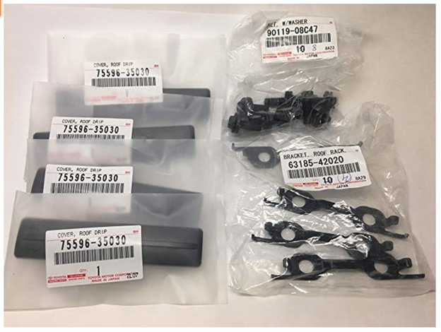

    Would removing the roof basket on a 2020/2021 TRD Pro be similar to the video below on removing the rails of a 5th gen 4runr? Same bolt removal procedure?
    5th Gen 4 Runner Rack Rail Removal Procedure https://www.youtube.com/watch?v=8qu7Plf8Leo
    Here are two bolts from the video on a non-trd pro 4runr.
    I’m assuming the bolts in the picture above go into the same holes in the TRD PRO basket identified by the red arrow below.
    These are the bolt retainers/glides that has been noted that can drop into headliner.
    These are the rail plugs Toyota sells for the 5th gen 4runr. In description it below it lists to model year 2020. I am assuming they are the same for the TRD Pro. I purchased them to remove my basket at some point in the future. I’m hoping it’s a straightforward process as I would like to have the option to have the roof basket on and off as needed.

    It’s the same procedure as the Pro roof rack but the difference is Toyota puts red lock tite on the torx head bolts at the port. That’s why you go back and forth with each one with just a little turn.
