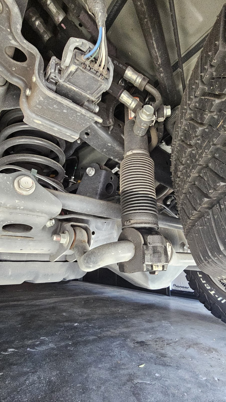

    Has anyone had to replace this? I'm thinking mine is shot? Man this part ain't cheap either!
    Should I not even be driving it like this? Was planning a short road trip down south this weekend too.

    KDSS. It's not dripping but keep an eye on it.

    Safe to drive
    I wouldn't even worry personally

    If it was me I would replace when the KDSS rams starting to leak. I've seen front ram shaft completely broken off the swaybar. Sure the front leaks are common but rear is not as much. But still me personally would not ignore when they are showing signs of failure.
