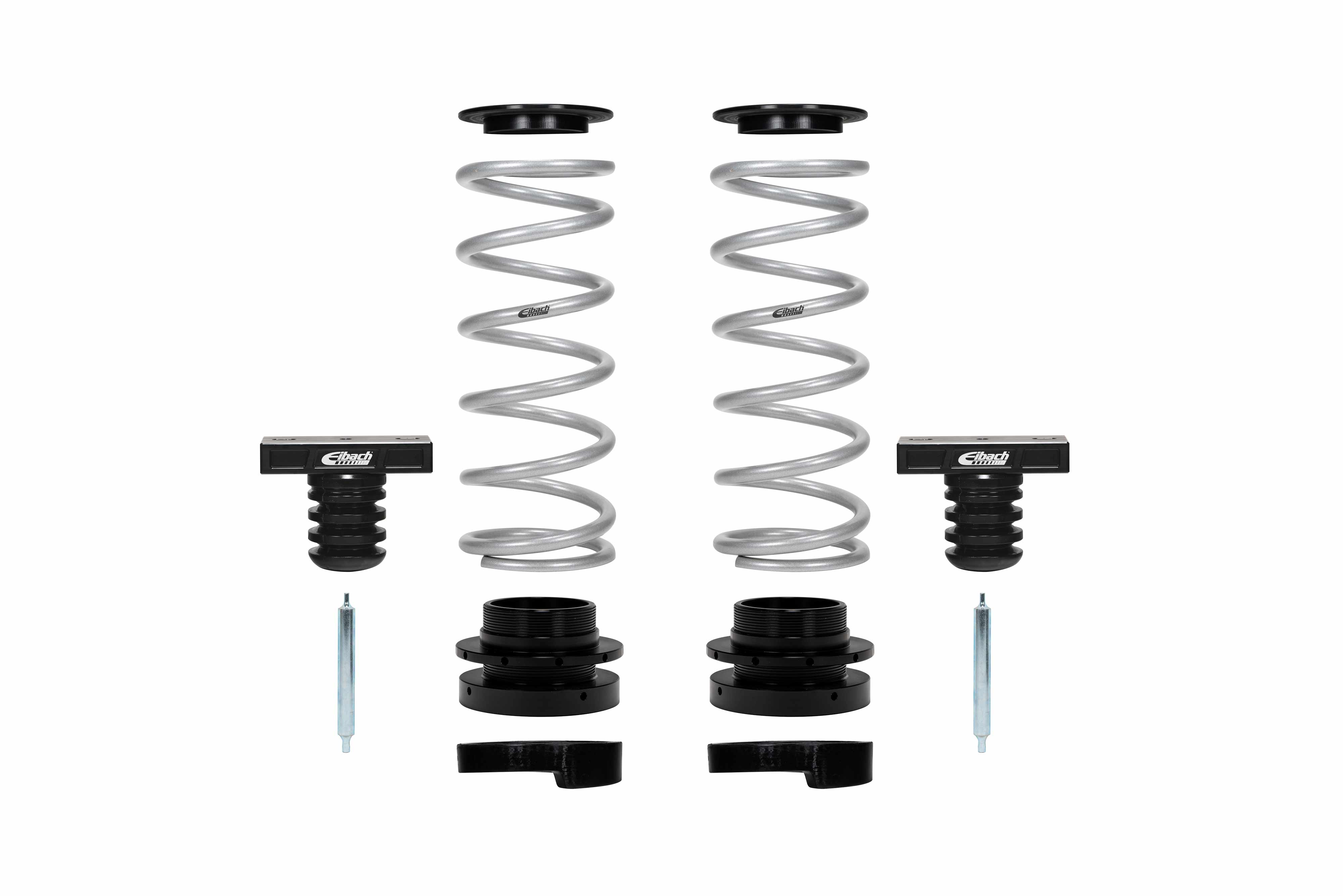

    If it's just the rear suspension that you want to replace/upgrade you might consider the Eibach Load Leveling System. Comes in three load ranges; 0-200 lbs. / 200-400 lbs. / 400+ lbs and are adjustable up to 2".
