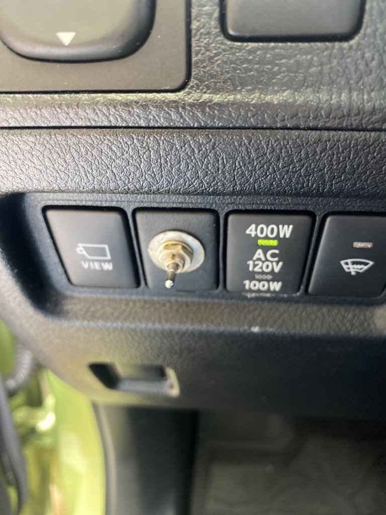

  15. Dec 14, 2021 at 7:08 AM
    kwill
    kwill New Member
    Aug 4, 2021
    #22664
    105
