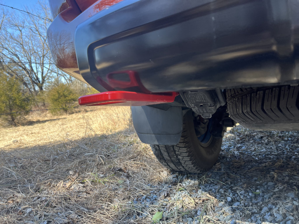

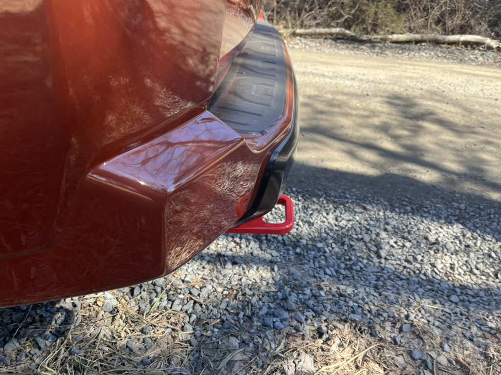

    I was thinking about getting these but they look like they come up super close to the bottom of the bumper? Do you find that it rubs against the black valence cover? Any issues with the valence getting in the way during install?

    IMG_8184.jpg No issues with the valence cover during the install. The rear valence makes contact with it, but nothing that hindered install or would worry me at all.IMG_8185.jpg

    23 MGM ORP w KDSS
    Thank you for your write up and those extra detailed pics. You've helped me decide that I'm going to get these. I initially wanted to get the ones made by Apex Overland, but I have KDSS and I do not want to deal with drilling into the frame.
