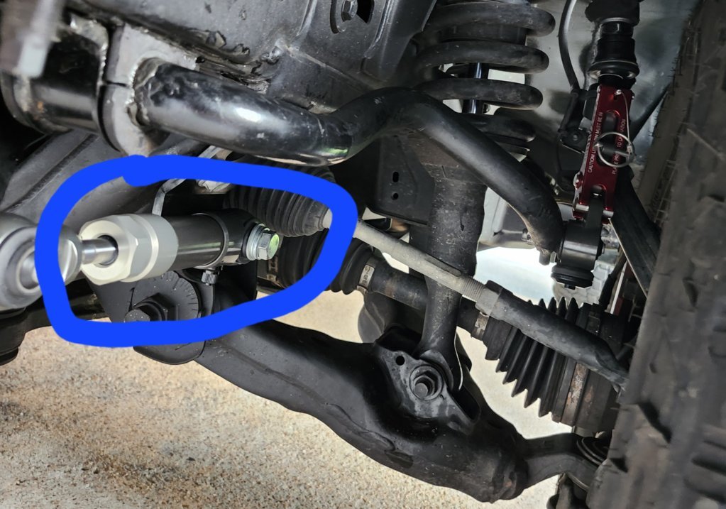

    Ok Gang - on the mods that have literally kicked my a$$ from a DIY point of view:
    The swaybar disconnect links by Apex Designs. This is a super nice to have if you are offroading and you want to have extra flexibility and more articulation. I believe the new 6th Gen 4R has this on electronic version as well as the 4th Gen taco and LC250. It is a push button and you are done. Us on the 5th Gen, we have to go thru the manual procedure of going underneath and disconnect and hope nothing goes wrong after that. The creator of the product gives a fair warning that if you are not a DIY kind of person, best to take this to a professional shop. I was stubborn and literally spent one week with the 4R in the garage trying to do this myself. I ended up getting my neighboors help but I got it done! It wasn't because one thing is understanding what to do, and another one is having the skills and natural ability to do it. Anyway....on the relevant pics for this mod:
    Going in and behind up in the air.jpgThis is the problem - the swaybar fixes both wheels for the most part, without the swaybar you get more articulation.
    The installation:
    Nice looking product - very well done. Several videos out there on youtube. Recommend you get familiar with it if attempting this yourself.
    Got everything setup in jacks and already removed the swaybar etc. A task that I thought would take 1 day, it took more...don't ask why.
    The right side with the pressure system thing on the left side.
    Left side done.
    I have tried the product already three times during my offroading adventures and I can say it does make a difference. Don't forget, you get done on the trail - air up and PUT BACK on the swaybar. I can tell at higher speeds if I have the swaybar connected or disconnected. Some folks don't care, but my boss here at home didn't like the feel without the swaybar.
