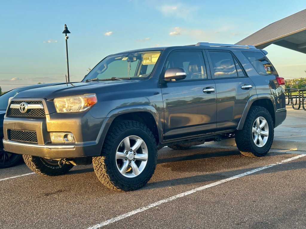

    Scoty
    No spacers and no rubbing on my setup with TRD 4RP alloys and 285-70 rubber bands.
