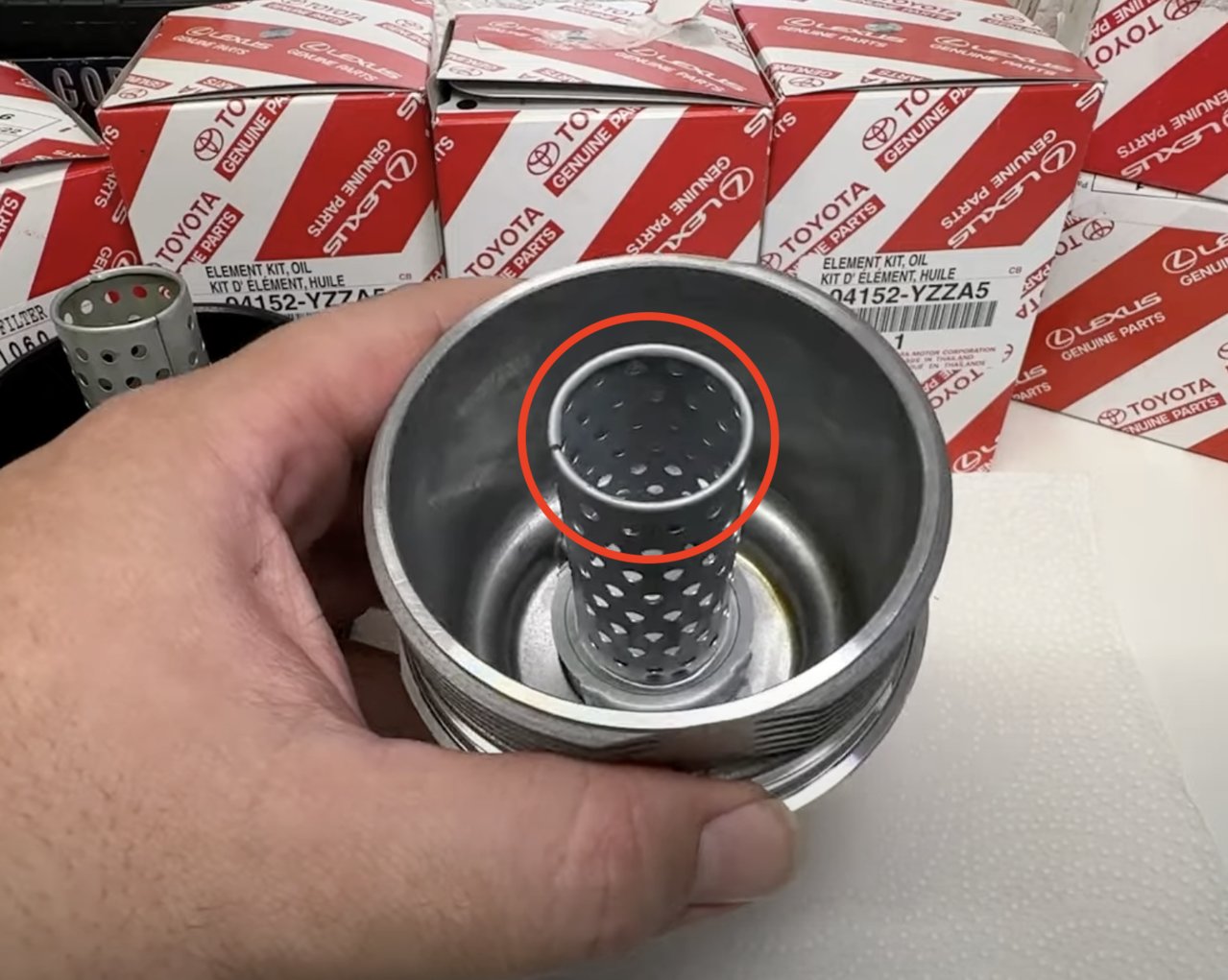

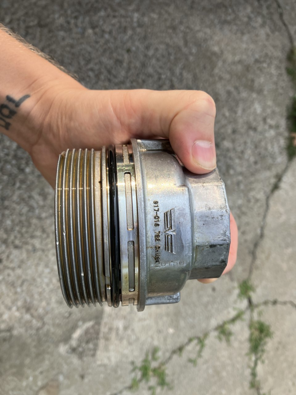

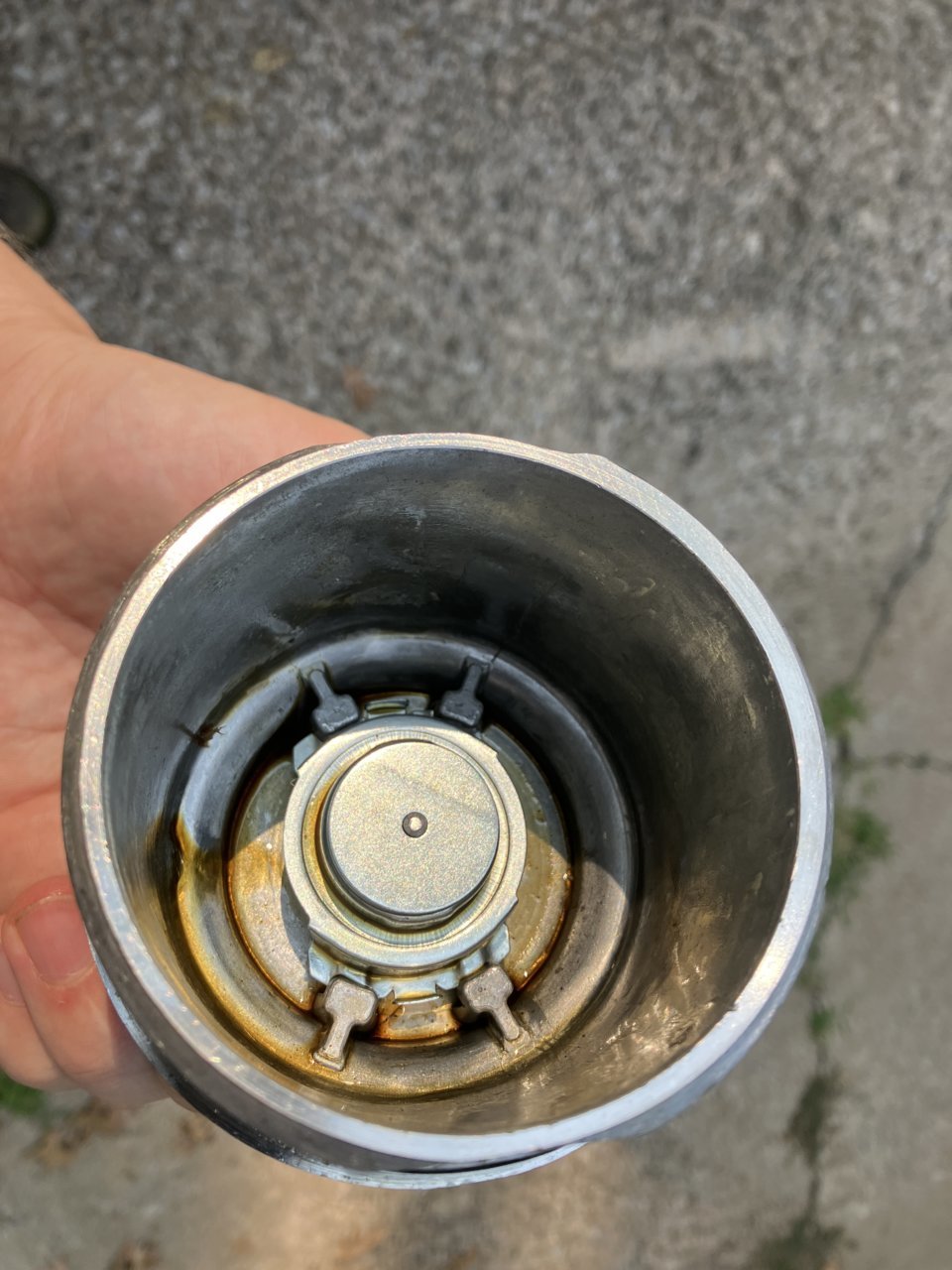

    UPDATE: after all the very clear advice I have acquired a brand new filter housing(OEM) right at the opening of the parts department this morning and it will be installed right after this update. I'm glad to have the peace of mind now doing my own oil and disappointed I didn't start sooner after finding this. All paranoia is now justified haha. I'll likely do my my next couple oil changes on the early side and send to Blackstone just for safety's sake as well.
    original: Well, I just completed my first oil change on my 4Runner. Through my two years of ownership, I've just taken it to my trusted mechanic, but recently decided I would feel more confident and comfortable doing it myself - no thanks to the influence of you paranoid forum folks, jk. So, when I removed the housing which was definitely overtight, I found no center tube at all inside my metal housing? I checked my old filter for it, and checked to see if there's anyway it could be up at the attachment point (name for that?), but no luck. I don't suppose this is urgent since apparently, I have been driving without one for at least 5-7k (since my last change) or potentially about 50k in my time of ownership, let alone if the guy before me didn't ever notice?
    Anyway, just looking for peace of mind and/or advice if I should urgently go get the center tube for the housing (part # for me?).
    tl;dr - just did my own oil change for the first time & there's no center tube in my metal housing, just a filter. (not my pic)

  2. Aug 17, 2023 at 8:40 PM
    2,970
    It holds the filter in the correct spot and keeps it from collapsing. You definitely need it. Get a plastic housing from Toyota and leave it because the metal housing isn’t really an upgrade.

    That running without the center tube was a mistake.
    People have posted on here wondering if their oil was filtered less due to a shorter center tube found in their filter housing...you didn't have one at all.

    There is a direction of flow that the oil has to travel inside the housing in order for the oil to be filtered. A filter that’s not held in position inside the housing is basically just going to float around and just be saturated with oil, but not actually filter anything. So running it without a tube is basically like running no filter at all. It won’t kill the engine all at once, but it’s not good for it.
    The metal filter housing is not a standard part that comes on the 4runner. That suggests the previous owner “upgraded” it to the metal version used on other toyota vehicles. The problem is, when you swap out to a metal filter, the tube from the 4runner plastic housing needs to be swapped into the metal filter (toyota metal filters from other models have a different length tube). It could be the previous owner didn’t adequqtely mount the tube, and it came off in the following oil change.
    Potentially you’ve been running without engine filtering since taking ownership, if this is the first time you’ve noticed. Or it disappeared on any subsequent oil change.
    Unfiltered oil wont kill an engine all at once, especially if you don't drive in dusty conditions. But it will probably lead to earlier wear…maybe showing up as increased oil consumption or reduced compression earlier than it would have otherwise shown up. If it’s not burning oil or running bad, I wouldn’t worry about it. Just buy a complete OE housing assembly and stay on top of your oil changes.

    Brother, you HAVE TO have that inner spring/tube in that filter housing installed. CarCareNut on YT has one whole episode about the significance of that tube. That piece of filter housing that you have currently is a piece of trash now.
    Get the oem one from Toyota.

    tube keeps the filter from collapsing. the housing is what keeps the filter located in place. the base of the tube retains the spring for the bypass. no tube means no bypass so oil just flows freely through bypass and not pressurized through the filter.

    And when swapping out the tube from the old housing you need to recrimp it at the base so it stays in place. I bet that it was never securely crimped in and probably got discarded at the last oil change because even a novice like me wouldn’t let you drive off w/o alerting you if I were doing your oil change. Just my hunch.

    I did the metal upgrade, which is basically a Camry, RAV4 filter housing with the shorter tube and a straight change out for those cars.
    When I did the metal change out on my 2020 Off-Road, I changed the spring and the tube. The spring is at a different tension than the spring that's included in the $30 OEM aluminum housing for the 2AR-FE engine.
    I decided, since I bought new this time, that I'll stick with the plastic one. My 2020 was not only used, it was a former rental and the plastic housing and been seriously overtorqued (it took an impact drill to back it off).
    It is too bad that you had an emergency need, for somebody looking at this because they have a similar situation and can wait for shipping... Of course, I wouldn't encourage ordering one and then taking the unused one back to the dealership for a refund, oh, no...
