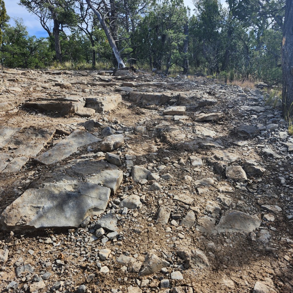

    For my stock '21 TRD OR I'm considering this: the kwikLYNX - TOYOTA SWAY BAR DISCONNECT. Obviously I don't have KDSS on mine and I definitely need to be in touch with the ground when crawling on more than 2 wheels, see attached pic... Anyway, has anyone considered or done this?
    https://www.apexdesignsusa.com/products/kwiklynx
    It would be nice to avoid this kind of action (but in the front):

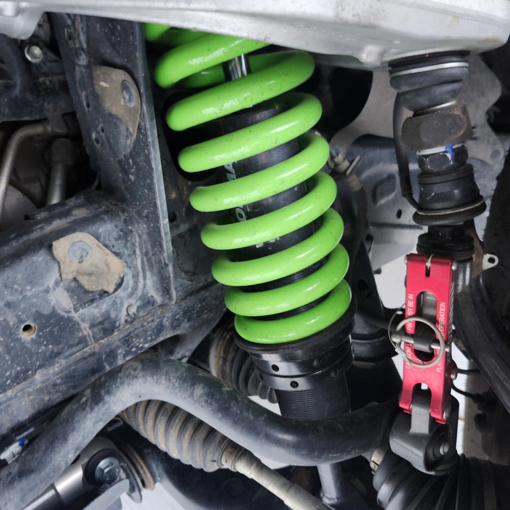

    I considered this but I have spindle gussets… so I’m out.
    I’ve since just removed the front sway bar entirely. Much better flex and still nice and stable on the road.

    You will still lift a wheel on that spot

    Agreed, but I think he'd have lifted quite a bit less. You can see how that front sway bar is not allowing the front suspension to articulate at all.
    To avoid wheel lift entirely here I'd go with front sway bar delete and long travel rear shocks.
    Without going full long travel front ($Too much coin for me.$) the rear long travel shocks/ springs make a huge difference in these rigs capabilities. Dobinson's offers them at a great price point. I was very surprised what some extra droop allows for.
