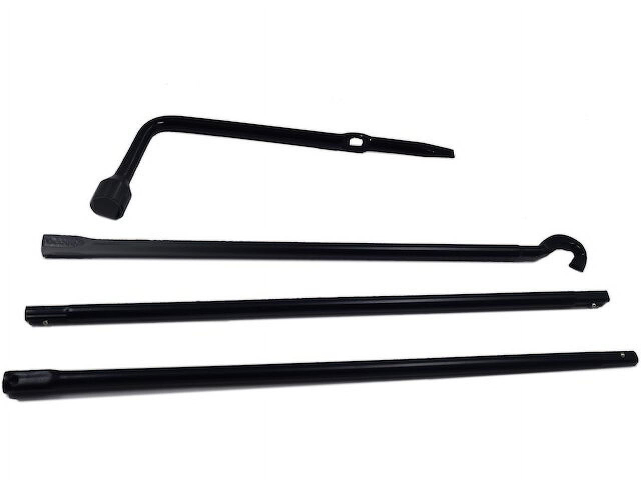

    What all comes in the tool kit that normally stores with our jacks? I noticed today my new (to me) 4Runner is missing everything but the jack. Is there a part number for the entire kit or do I need to buy each piece?

    There's a roll with the extensions for the jack/spare holder.

    ya you need the kit to get your spare down from under the runner.

    I bought it from Carvana. Their website specifically states that removable accessories like the car jack are not guaranteed to be included. So I doubt they'll help replace it.
    Can't seem to find a used one on eBay unfortunately. I did end up finding what I think is all the part numbers for everything in the kit. Comes out to like $120 from an online parts dealer. Might do have to do that if I can't find a used one.
    Tool bag: 09120-35170
    Wheel cap wrench: 09183-00030
    Lug wrench: 09150-26010
    Jack lever: 09116-60020
    Extension: 09114-35060
    Handle: 09115-35110
    3JOH22A[QUOTED] and LCJ77 like this.

    ^^^ I keep an 18" breaker bar as well, but still have to have those jack handles in order to lower the spare. But yeah, using the Toyota provided jack handle to remove lugs? Pass.

    Hmm, maybe I’ll just not buy the factory lug wrench and replace it with a breaker bar and socket. My truck did come with a factory installed security lug option, so not sure how they expect you to change a tire using the factory lug wrench and a security socket…

    If you have the "security lug option", I presume that means each wheel has a lug nut that requires the key to remove it. I hope you have that key (a lot of people store that key in that tool bag). Otherwise, you will have to figure out how to remove those locking lug nuts or have a tire shop do it for you.
    The way you remove a wheel with the usual tire lug wrench is one side of the lug nut key is the same size as the other lug nuts, so you put the key on the locking lug nut then remove both with the wrench.

    It did come with the lug nut key in the glove box. Never looked at it closely, I see now that it fits in a 21mm socket. For some reason I assumed it would have a standard 3/8s or 1/2in socket input.

    Most wheel keys are hex drive, so the same socket for the other 5 lug nuts are used to drive the key (and the foot-long lug wrench included in the OEM tool kit can drive it).

    I actually LOVE Toyota factory lug wrenches. You use your foot to "break" them loose. I can do a tire rotation in ten minutes. Im sure your spare is not "locked up", because I still have my original spare and it drops down no problem.

    I went ahead and ordered the parts online. I didn't want to deal with hunting for a salvage yard kit and having it end up missing things. Thanks all for the replies!
