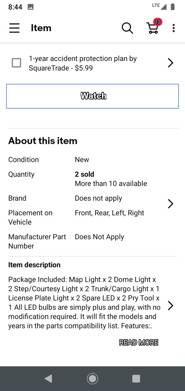

    Roads, I used all of the information you provided me with and found a kit that worked out perfectly for me, even gave me LED for places I don't even have! I still need the shifter indicator and climate control LED's, but the rest are in and look fabulous! Have you ever actually replaced the lights in the door and window switches, seems really small!!!

    Hey Atomic do you mind sharing a link to the kit you purchased? I’m currently looking for one myself. Thanks!

    https://www.ebay.com/itm/123286210240
    I'm not sure if I created the link properly or not.
