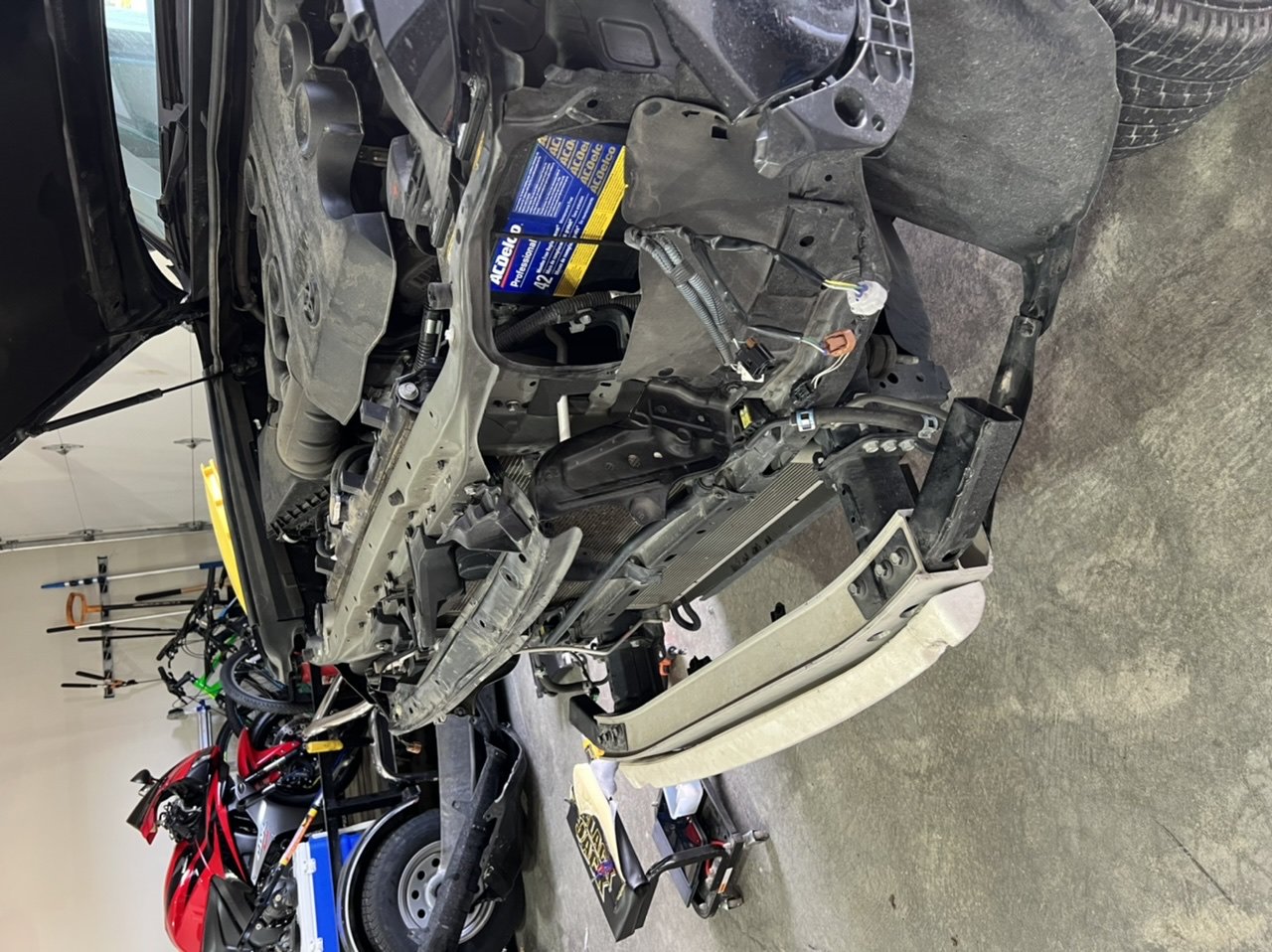

  19. Feb 7, 2022 at 2:18 PM
    CAT3AutoLand
    CAT3AutoLand [OP] New Member
    Feb 5, 2022
    #25511
    25
    2015 Trail Premium
    Got it on The trailer, took part of the bumper cover off that was hanging, and the headlight that was a little loose.
    The aluminum crushed bumper underneath the bumper cover wasn’t touched looks like. Nothing under there looks bent From what I can see, will get everything off tomorrow. Also started right up and sounds good.
    Did not drive it, but the green Diff or 4 x 4, or something is blinking green…..
    Here are the initial quick pics.
    If you see something please let me know,
    Thanks

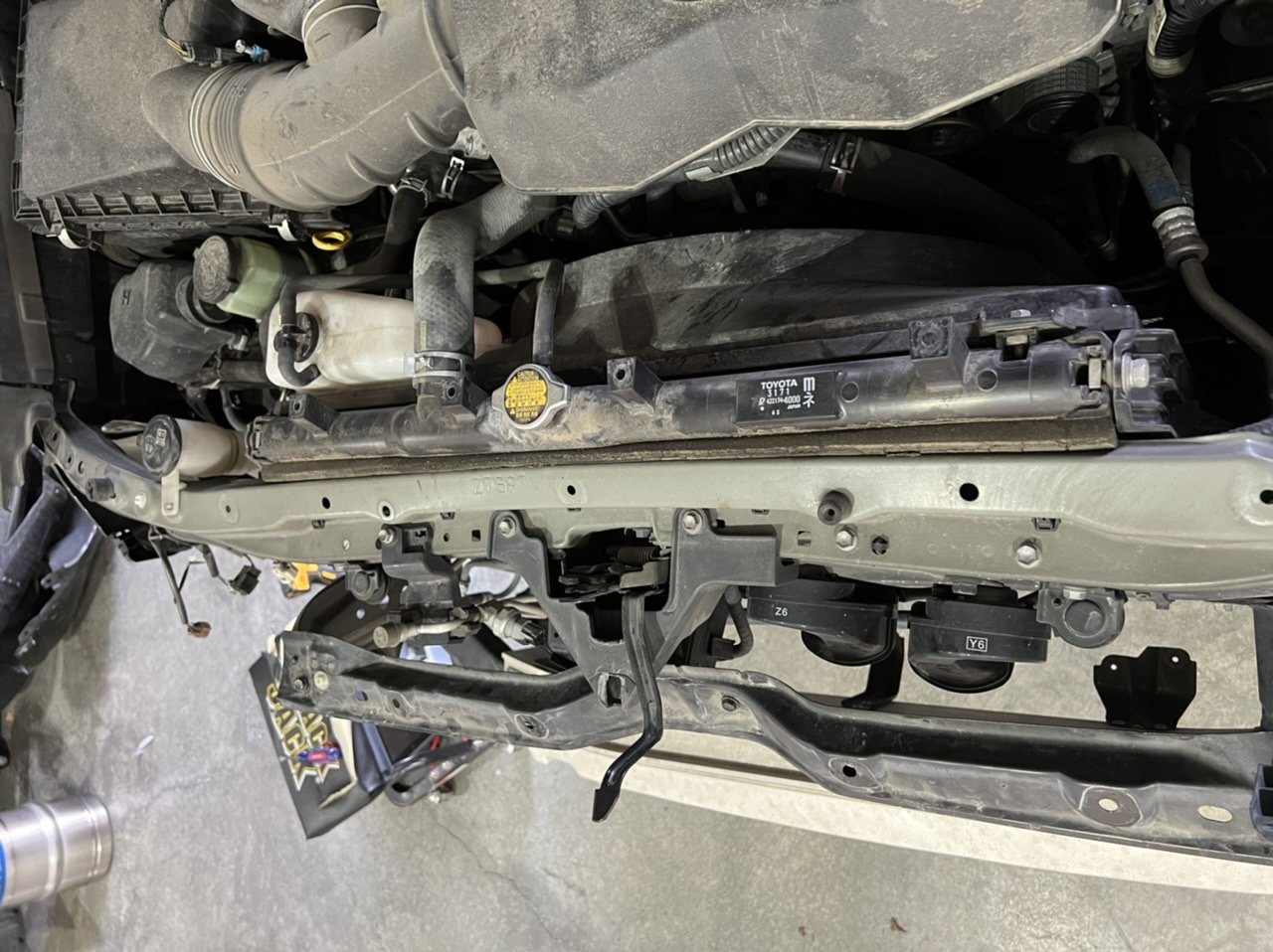

  20. Feb 7, 2022 at 2:32 PM
    CAT3AutoLand
    Feb 5, 2022
    #25511
    25
    2015 Trail Premium
    DAEE2DA1-3775-4E57-B87C-537BCB467B93.jpg 07DC372C-8101-4617-B2B8-57F73723F5F1.jpg 3E94EB66-4F30-4AB2-92FB-D9F75641DEF6.jpg 6765A2E9-8016-4FC0-9403-A448C2A27207.jpg 3F2E6B58-794B-4CD5-934F-E2065892832F.jpg 1FC192A4-F86D-4B38-8CD7-75A7F3891BD8.jpg 6155B1FA-9E20-43C1-9AB2-22F3270400BB.jpg
  21. Feb 7, 2022 at 9:41 PM
    5,479
    This is an untrained eye speaking, but nothing looks catastrophic. You may have yourself a score! But did the rear take a hit too?
    Headlights are going to be expensive, unless you can patch up the tabs. Hopefully, the AC lines are still holding presure, but it looks like they are at least bent.
    The 4wd light may go off when you drive it. It could be it was actuated while standing still and the axles never clicked in and locked. Dont take it out of 4wd until you drive it forward 20 feet or so, to give those front axles a chance to lock. If the light does not stop blinking, try to go into 2wd and maybe it will go out. If not, then it could be the engine was shut off right after somebody put it in 4wd and the front axles never got the signal to lock. There is a switching system that has some dead zones where the switch is between contacts, and if tge car is shut off in this no-mans land, the car wont know if it’s in 2wd or 4wd. This will need a dealer service dept visit to sort out. There is a toyota tech youtuber called “car care nut” that explains this in his 4runner 4wd system video. He’s a really good resource. Remember, it’s a part time 4wd system, no center differential, which means you should not make turns in 4wd or you’ll bind everything up. Read the manual for operation instructions.
    Also, is this in Illinois? Rust looks to be very minimal, which is good.
    Im assuming that you’d be the one that has to title it as salvaged since an insurance co sold it? Weird though, since it seems repairable. Good luck, hopefully you dont find any nasty surprises.
    edit: what is that chain tied on to? Hopefully not the crosslink?

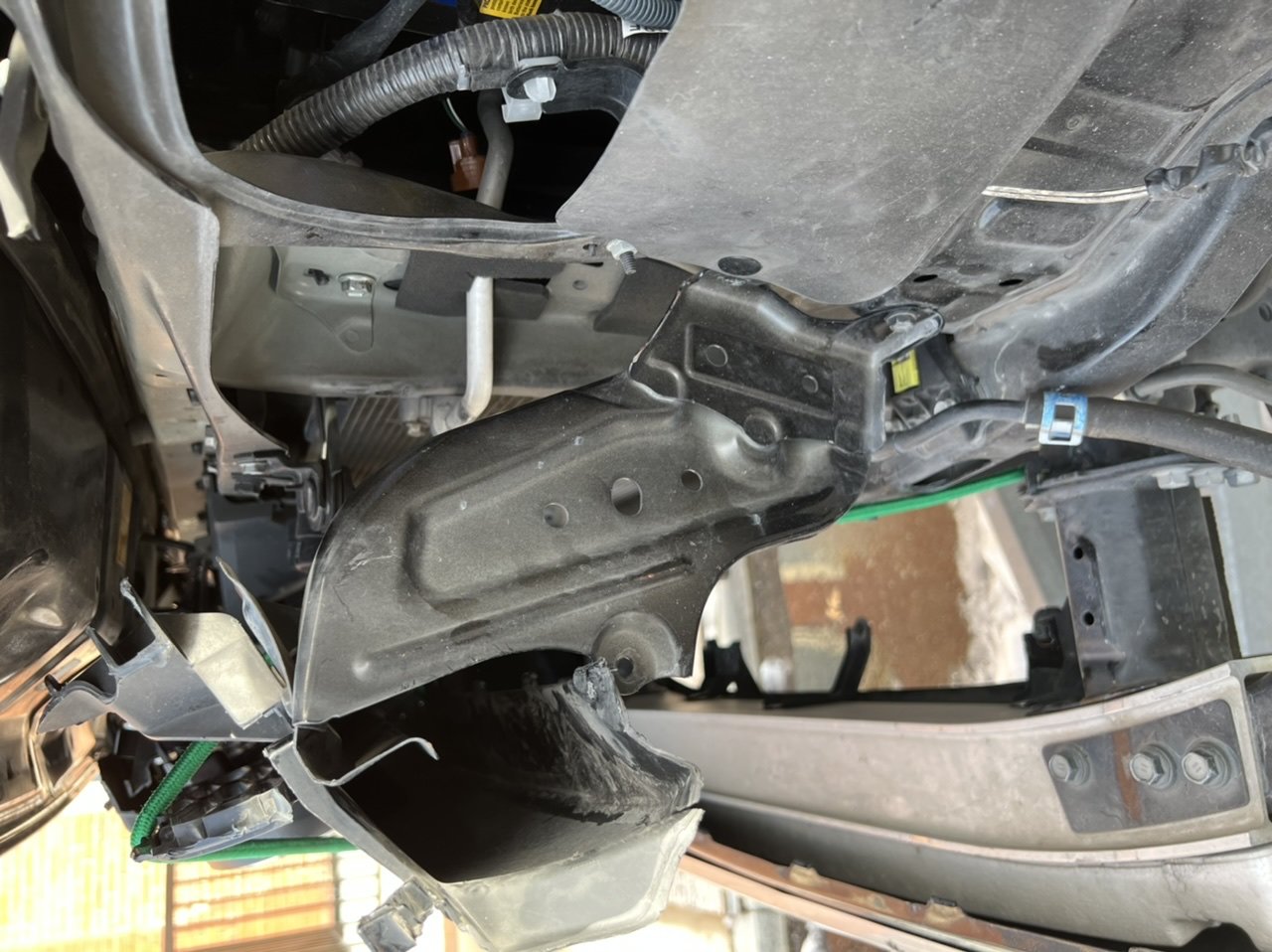

  22. Feb 8, 2022 at 11:42 AM
    CAT3AutoLand
    Feb 5, 2022
    #25511
    25
    2015 Trail Premium
    So I removed the bumper and salvaged the fog lights, I removed the headlights, will have to look at the tabs.
    What do you guys see? I don’t see anything severely bent, there is a metal bracket I believe was holding up the bumper, looks a little crooked maybe.
    I need to look at other pics to compare
    How does the radiator support beam look? Is it supposed to be at a downward angle or is it bent. No holes or damage to the radiator, actually it has no leaks at all anywhere, drove it around everything works except a green flashing light for multi terrain and trac is off…..

    The Core Support is definitely tweaked on the driver side, both top and bottom. The Bumper Cover Support Rail is junk and I would assume several of the brackets that support it are gone too.
    It's a little late in the process, but I would have gotten an estimate from a collision shop and that would have given you all of the parts and part numbers you need.

  24. Feb 8, 2022 at 12:27 PM
    5,479
    @CAT3AutoLand here are some reference pics from when I put in my winch bumper:
  25. Feb 8, 2022 at 12:41 PM
    CAT3AutoLand
    Feb 5, 2022
    #25511
    25
    2015 Trail Premium
    That helps Mcspaz, thanks.
    Just trying to get a game plan on best way to go about the repair. Order bumper headlights and straighten out the rest? Do I need to order core support?, Get new fenders, straight in the hood etc….
  26. Feb 8, 2022 at 12:46 PM
    CAT3AutoLand
    Feb 5, 2022
    #25511
    25
    2015 Trail Premium
    41084299-B32A-4F55-ABBF-1751052F9A50.jpg 0274C272-6A34-4B98-AB95-051ECC4C3C3C.jpg 6A88D853-4B86-458A-BD12-59956CEE4199.jpg
    Yes looks like my headlight housing on one is cracked, and tabs broke off the other, not sure if I could salvage any of that or just need new ones?
    What to do about the core support? Try to straighten it or replace.
