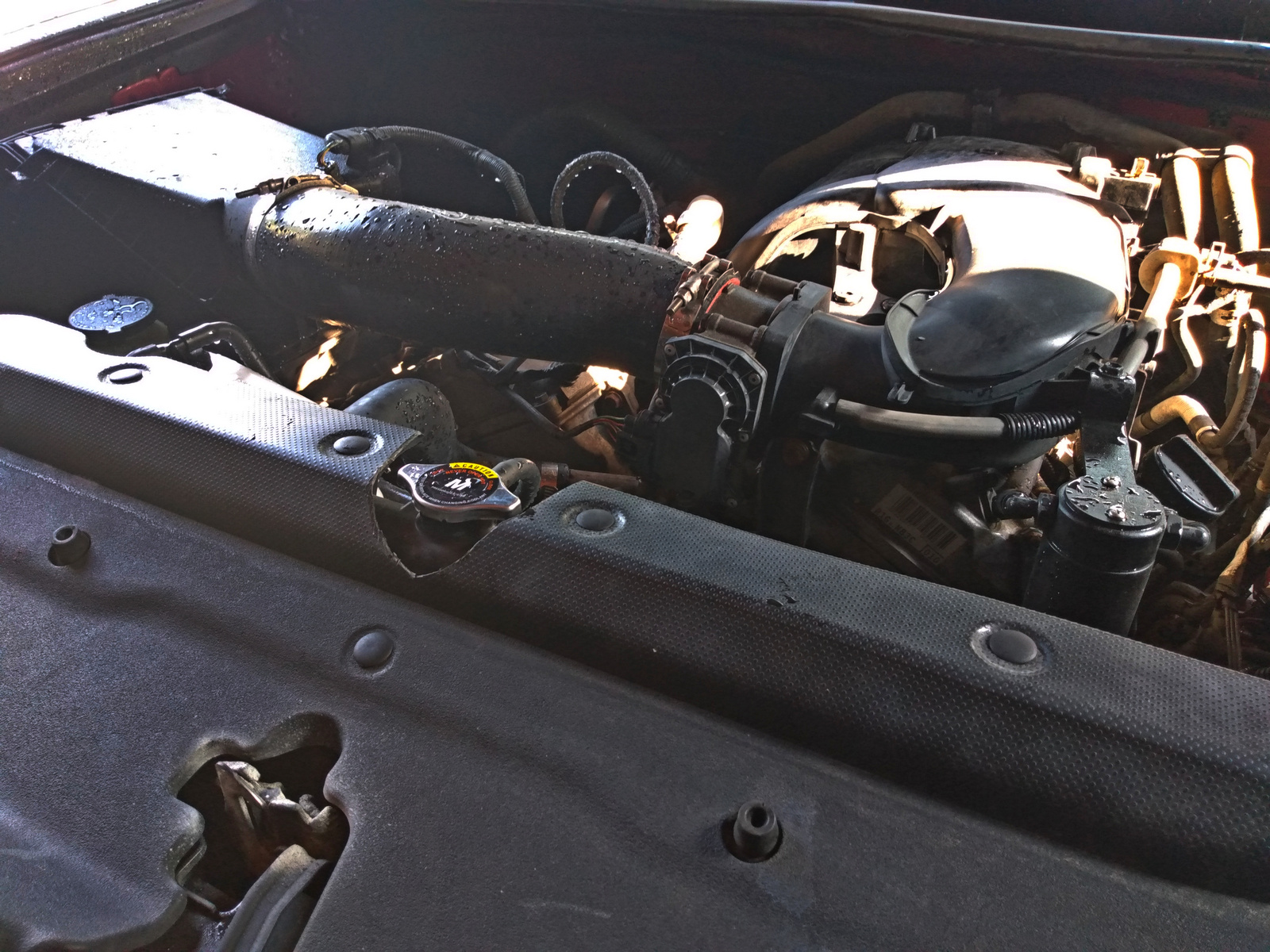

    Turned out the coolant leak was my own doing. :D The Toyota adapter for the pressure tester arrived today and I was able to put some pressure in the system. At 14 psi a steady leak formed at the upper radiator hose going into the thermostat manifold:
    AP1GczMq86cwqb5lvqO6tmd8PSWugXApQUtt9bvs_3a8be7a0a7759f3ef2c5d51a8cb0b9fd01b17ad4.jpg AP1GczPpgloDAsojELFgM_t7aCPaU2hxgyUIfKLF_60c61c8a4d418474e4a7b447aec8fd7103e806d1.jpg
    The fix was to reposition the clamp a little and cinch it down with a small ratchet. I then pumped to 15 psi, no leaks and no pressure drop after 15 minutes.
    Made a cutout in the upper radiator shroud, so the radiator cap can be accessed in the future without removing the shroud:
    AP1GczPzD09B-CE3f5AkSucK2MGoIn3rYx4WfcJ0_37a45b12be03b8d68850d3e74e220bd8f2fed1b2.jpg
    Tools used:
    8MileLake D0065631 radiator pressure tester: https://www.amazon.com/8MILELAKE-Radiator-Pressure-Tester-Cooling/dp/B07GQN18YF/
    Motorad 3125 Toyota radiator adapter: https://www.rockauto.com/en/moreinfo.php?pk=5551020&cc=0&pt=2054&jsn=1

    he used wrong clamp. Toyota clamp "alive" and maintain grip at temperature fluctuations. clamp OP used was installed and tightened cold. when engine warm up, hose squished under that clamp and eventually gets "cut". Instead replacing hose and clamp with OEM parts, OP just pulled hose little more and used wrong clamp. I am sorry for bad wording, not very technical. Resume: always use OEM parts.

    I placed the hose clamp too close to the lip of the manifold outlet. It may have been exasperated by the Gates hose's bend radius near the end being slightly off. I normally prefer Continental hoses (like the lower hose I used), but the Continental upper hose wasn't in stock at the time of order.

    The OEM spring clamps don't survive our salty winters because they aren't stainless steel. In the rear of the 4Runner, I've already had to replace a few spring clamps in the evap system that had split open from rust. It's also a constant battle with my father's Subaru - every few months, a factory spring clamp fails and causes a transmission fluid leak; I replace it with an SS hose clamp, the leak stops, then another factory spring clamp fails soon after. Fortunately the Subaru's transmission still has a dipstick, so it's easier to top up.
    Automakers use spring clamps in the factory because they're faster to install and can't be overtightened (less prone to assembly error when a worker installs 900 of them each shift). The constant-tension business doesn't come into effect at typical passenger car hose sizes.
