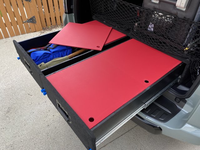

    I made custom drawers with removable covers that allow the drawers to be used as supporting surfaces for tailgating, camping what not. The covers are made from 1/4” HDPE. Each drawer has two covers that each cover half the drawer. My drawer slides lock in place at both half and full extension so I only have to remove one cover at half extension.

    They need to, but I’m sure that would make them even more expensive. If manufacturers do start, competition would help with prices. I used 1/2” plywood instead of typical 3/4” to help a little bit. They are still plenty strong enough for my needs. I also kept height smaller than typical drawers to further help with weight and still give me cargo space when needed.

    Thanks for confidence but my wood skills aren’t all that great. Sorry I just don’t have the time to build these. Mine took quite a bit of time as I could only work on them a little bit at a time. I even started them before I got my truck and still didn’t finish them before it arrived. Lol. I am happy to answer any questions though.

    I got it from McMaster Carr
