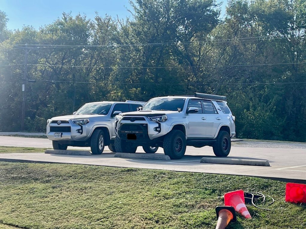

  5. Dec 23, 2024 at 6:09 PM
    5,672
    Here you go. Found one from when I had just finished installing the bumper and winch.
    Edit: it’s on stock sized K02s

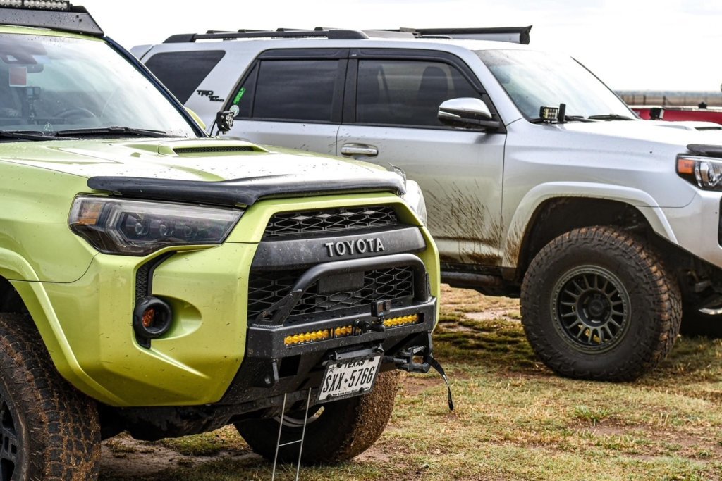

    IMG_3060.jpg I’ve got Dobinsons 302’s and 599’s but on Bilstein 5100’s. I also have an SSO bumper, Warn Winch and full RCI skids…
    here’s a pic for what it’s worth…
    Cheers,
    Bob

  10. Dec 24, 2024 at 10:07 AM
    5,672
    Funny you should ask, here’s a pic (with a similar angle) with 285/70-17s. I got these tires about a year and a half ago. I like them. Doesn’t change the look dramatically, but it’s nice having a tiny bit of extra height. A half inch is a half inch lol. Is it worth it? I kind of think so, but you’ll pay for the benefit. The change to the gearing is noticeable, but ultimately ignorable for me. Also, the gas mileage went from bad to slightly more bad.
  11. Dec 24, 2024 at 10:16 AM
    5,672
    285s look better when the background is cooler.

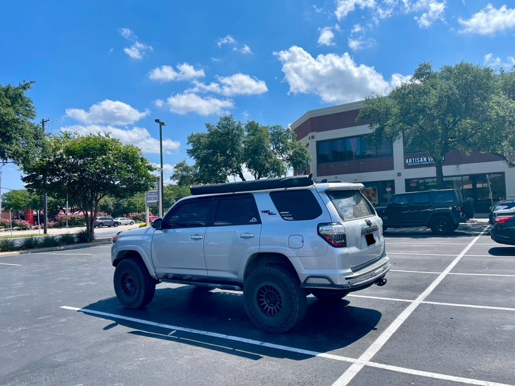

  14. Dec 30, 2024 at 10:37 AM
    deltabravo
    deltabravo [OP] Strongest steel is forged in fire of a dumpster
    Feb 14, 2021
    #19765
    132
    East Coast USA
    Anywho.
    here is my 4runner with 314 springs on the front and 325s on the rear with the IMS set up
    And here is my 4runner after switching to a 302 front and 599 rear. I like the after pics way better.
    McSpazatron likes this.
