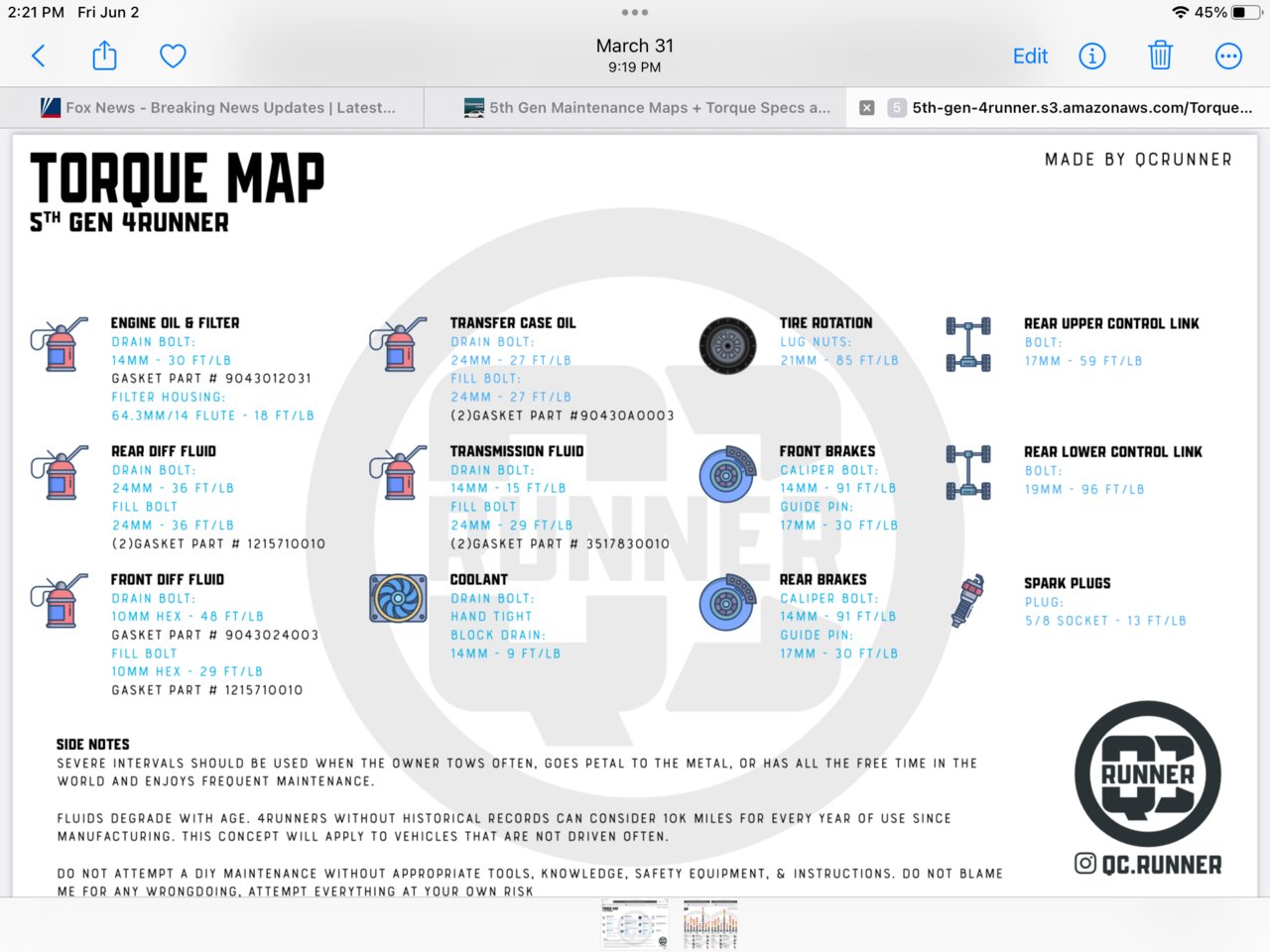

Diffs and transfer case drain/fill bolt torque values?

    I have the “torque map” available on this forum. I see the owner’s Manual doesn’t specify and torque values on these 3 items. I assume these values come from a 4 Runner repair manual? Looks like the transfer case is some alloy (aluminum, magnesium) and have lower values. The front and rear diffs look to be steel. I would imagine the fill bolts are less likely to leak than drain bolts. Anyone had any problems using these values? The bolt size for front diff (10mm)
    is listed much smaller than the other 2 (rear diff and transfer case) at 24 mm.
