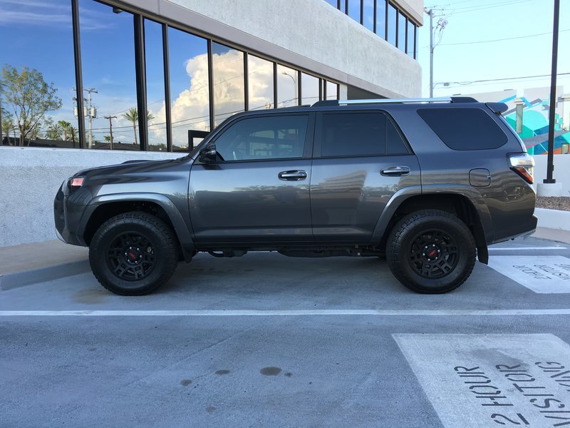

  11. Jun 29, 2016 at 5:59 PM
    Kilos
    Kilos Peaceful warrior
    May 23, 2016
    #2053
    27
    2014 4Runner Trail 4x4 w/KDSS
    TRD black wheels, TRD grille, Bilstein 5100s w/.85 in front
    Armena, 2Toys, SKT_07 and 2 others like this.

  13. Jun 29, 2016 at 8:29 PM
    brochacho
    brochacho New Member
    Jun 20, 2016
    #2179
    467
    2018 Sequoia TRD Sport
    Looks, great!!! Thanks! I may just go .85 I like a little rake.
    Kilos[QUOTED] likes this.
