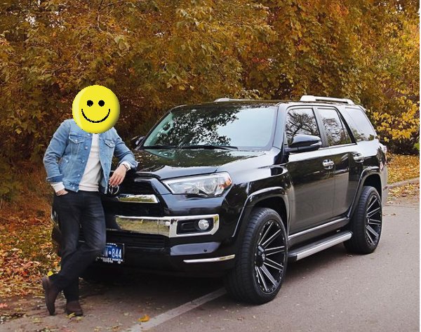

    Hello. New to the group. I have a 17 limited 4runner. I'm in the market for new rims/wheels and saw this pic. I really like the look. The rims are 24x10, with a 5.97 backspace and +12 offset. They also have 22x9.5 with the same specs.
    I know the ride will be rougher, and most think this is dumb, but I just want to make sure they will work...with no rubbing/touching on the brakes/suspension?

    It's gonna be tough to know if it'll fit as most of the dudes here haven't tried running 24's.
    I personally don't know about running that tire size, but I will say those 295's are 11.6" wide, which is pretty wide for our 4Runners.

    So from a math perspective, what's the overall diameter of the wheel and tire? the overall width? I don't mean the wheel, I mean the wheel and tire. I assume tires like this don't stick out from the wheel, so it's probably just the specs of the wheel + 1/2" on each side for width, but don't know the overall diameter with knowing what size tire you'll get.
    And the offset with that backspace is uncommon, a normal one is like 4.75 I think. However, with +12 you'll be going in toward the vehicle from the starting point of 5.97 so that approximately 0.5" in making a backspace of approx 5.4". That should keep it off your upper control arm (UCA), depending on the width of the wheel and tire.

    Update, looked up 295/35r24 and they appear to be around 32.1" and about 11.6" wide. That's about 1" wider than OEM size, but half that since the radius is what you care about regarding how close you get to the UCA. I assume the backspace of the wheels will move it out enough.
    At this point my initial thoughts are, it probably will rub slightly at full lock especially in reverse, and minor trimming required. If it does, and annoys you, a 1.5" lift likely fixes it. I'd go spacer lift cause you'll not be offroading with that setup, and it's cheap, and other than a curb you're not gonna be stuffing that suspension I'd guess.
    Summary, I think it might rub with the 24x10. You may stand a better chance with 22x9. Expect minor rubbing and fixes, most are easy. A little trim, remove front mudflap. I don't think rear will have any issues at all at either size.
    Also, my tire experience is with offroad, so that might *not* translate perfectly to pavement vehicles, but I think it's close enough for this.

    I was going to originally go for 22" rims, since you have more options with the rubber size, and the ride will be a bit smoother than 24's, but then I saw the pic above. I agree that it'll be close with rubbing, especially at full lock in reverse with 24's. Common sense says stick with 20's...but 22's would look better....and to me, 24's would look AMAZING!! But, I'm not going to spend money on lifts, if it doesn't work.....and these rims are custom bored at the factory...so ONLY another 4runner owner could use them if I had to sell. So, I have to make the right decision before dropping a penny on these things.

    One other thing to pay attention to is with that positive offset bringing the inside of the wheel closer to the vehicle, there is this small little nubbin thing on your knuckle right at the perfect height to rub against your wheel/tire... ask me how I know it gets close. In the picture I attached its the little thing that sticks out right above where you see the steering tie rod end and the bottom of the UCA ball joint castle nut (not where the arrow is pointing this is the best I could find on google) [​IMG]

    I might be concerned about such a wide wheel with a positive offset rubbing on UCA's. I can't help you with any real experience, though.

    So I pulled the trigger, and got the Contra's instead of the Diablo's. For my black 4Runner, I think it's a better look. I also like the stance of how this truck looks. I did the exact set-up.

    Since I'm stealing the look of the Runner in the photo, I asked the guy what he is running, and he put 285/45/22's. I ordered the same thing. He said that he has slight rubbing on the inner plastic cover/liner. I can always heat that up and manipulate it if need be.
    I should add, that I was going to order the 275, but they are like an EXTRA $60/tire.
